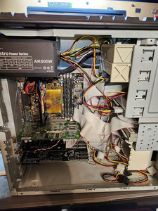

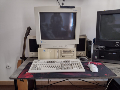

It is not the fastest...
It certainly is not the lightest...
But darn this thing turned out sweet!
Asus Tower with P2B Motherboard
P3 1.1 GHz Coppermine in an MSI Socket 370 to SLot 1 converter
512 MB RAM
Compact Flash Reader
IDE Drive Bay
AGP GeForce Ti4200
Voodoo 2
Soundblaster Live Platinum
Custom Fan Setup
500 W PSU
I'm going to put it through the paces next weekend.
The only issue is that the upgraded PSU does not have a -5 V power out for the ISA slots.
I don't plan on using them at this time and everything works perfectly.
Other than the BIOS yelling at me on every boot about it we seem to be fully working at this time.

Reply 1 of 8, by ubiq
No, that's pretty much exactly the right one for me thanks - I'll take two please! 👍
For the -5V thing, I have a P2L97-DS that did the same thing. I got it to shush by using one of those ISA slot adapters that's intended when using an ATX PSU on an AT board. And.. then I found the bios setting that let me disable the error. 🤭 Anyway, either might work for you.

very nice indeed, it will have a great range of software it can run too
i guess you can have CFs for different OSes and setups too

Reply 5 of 8, by Joseph_Joestar
tomcattech wrote on 2023-05-30, 03:49:
If you have a spare ISA slot, you can get a Voltage Blaster to solve that.

I also disabled the -5v warning in BIOS, not sure if that was a DS only option though?
