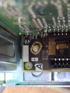

Thanks Tiido, I ran down stairs to look, and found the model number. Looks like an AOpen VI15G. (I didn't get a whole board shot because IDE/floppy cables and expansion cards are in the way) but if I had to compare it to one of the models on the link you shared, it's this one:
https://theretroweb.com/motherboard/image/mb- … ea251100338.jpg
It even says VI15G on the photo in the link above. I'll take pictures of the pin header once I'm done with work

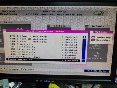

It looks like the turbo switch / turbo LED pins are dual purpose.. one use for energy efficient sleep, and the other for turbo functionality. Did you check the BIOS to see if there are any green/sleep/power options you can disable?

I checked just now. You can set it as "TurboKey" or "BreakKey" as shown in the attachment. When I set it to Turbo Key, the sleep behavior stops when I push the turbo button.

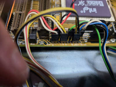

However, the turbo LED stays on no matter what. Not sure if it's readable, but I attached a pic of the pin descriptions on the board. Looks like the turbo switch could be 3 pin unless they planned a space pin between the switch and LED. I moved the LED pin header around, went to the right edge and saw the yellow LED light up with a red hue, so I figured one of the pins may have been 5r volts or more, so I removed it. Then I went to the left and strapped the next two pins after the turbo switch pin header and saw the turbo LED lit, but at half brightness. In addition, if I actuate the turbo switch while the LED is on the pins right next to the turbo switch (which would put it within what I think is a third pin for the turbo switch), the LED turns off when the switch is pushed in.
