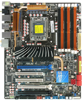

I find the Asus P6T Deluxe V1/V2 to best the best board out of the first generation x58 offerings. It has drawbacks but it's a really really solid motherboard and it's totally impossible to kill. If you need PCI and run SLI you can not use a video card that is wider than two slots in the first X16 slot and if the PCI-card is very long it might hinder the cooling of that video card a bit. If you do not run SLI you can use the second x16 PCI-E slot for the video card and use two full lenght PCI cards without them blocking anything important. The second X16 PCI-E slot can handle a triple slot card (and even wider if there is room in the case).
The slot placement on the P6T-Deluxe is almost perfect. I would have preferred a third PCI-slot instead of a useless crippled third PCI-E X16 slot at the bottom of the board but that is my only complaint. A motherboard that can run SLI with a dual slot + a triple slot video card and use a PCI-card at the same time is awesome in my book. There is also a PCI-E x4 slot above the first X16 slot that could be used for fast storage.
Here in Sweden these boards are easy to find for 25-75 euro, often including CPU and memory.
The Rampage II is also good but rarely cheap. The Rampage has a large Fujitsu Capacitor that will fail sooner or later but it shouldn't kill the board . The second X16 slot blocks the PCI slot so no SLI + PCI.
Among the second and third generation X58 boards I have less experience, especially with cheaper alternatives. The newest X58 motherboard I own is the Gigabyte G1.Assassin. The G1 Assassin is a cool motherboard and overclocks well even tough it has an odd VRM design but it isn't a cheap and it doesn't have a PCI-slot...
In general, in my experience, Gigabytes X58 boards overclock memory better but can not cold boot really tight timings which is annoying. On Asus it's more if it works it works.

P6T V1, probably V2 too, can't drop CPU voltage with overclocking. Infamous ASUS issue back from Core 2 era. Not good for day-to-day usage. Second generation of ASUS X58 motherboards, like Sabertooth, fixed that.

It's one of few drawbacks. The other mention-able one is that the P6T series of boards won't hold turbo multipliers above the CPUs rated power draw.
In my perspective neither of those matter unless in the case of the voltage you want to use a really high voltage 24/7 or in case of the turbo issue you have a multiplier starved CPU. I do not think either applies in this case.
Overclocking with X58 is usually at it's best using the 21x multiplier and sometimes the 23x if you have a great CPU or bad motherboard. The voltage issue is negated by accepting the overclock you can get at less than 1.4V and keeping the C-states enabled.

I second the Asus P6T. Good board - used to sell them in large quantities back in the day - got one for myself and I still have it, it still works (but I keep in a display case).
My favorite 1366 board (for practical reasons) is the Gigabyte X58-UD5 - sata 3, USB 3.0, very stable. The Asus is a bit faster, also very stable, and I have to admit I have a soft spot for it since it was part of my first high end build ever.
