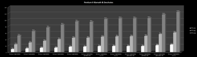

*** PII system results:
PII KLAMATH @133MHz
avg 23.6
min 8.6
max 51.4
PII KLAMATH @166 MHz
avg 29.2
min 10.9
max 64.9
PII KLAMATH @200MHz
avg 34.7
min 12.9
max 76.5
PII KLAMATH @233MHz
avg 39.5
min 13.3
max 85.3
PII KLAMATH @266MHz
avg 44.2
min 16.2
max 95.2
PII KLAMATH @300 MHz, @66MHZ FSB, CL2-3-3
avg 47.6
min 18.1
max 102.4
avg 48.4
min 18.3
max 104.9
PII KLAMATH @300MHz, @75MHZ FSB
avg 49.8
min 18.2
max 105.5
PII KLAMATH @333MHz, @83.3MHZ FSB
avg 55.5
min 20.8
max 116.6
PII DESCHUTES @350 MHz
avg 60.4
Show last 151 lines
min 22.9
max 124.8
PII KLAMATH @263MHz, @75MHZ FSB
avg 44.3
min 16.7
max 93.9
PII KLAMATH @292MHz, @83.3MHZ FSB
avg 48.9
min 18.2
max 105.1

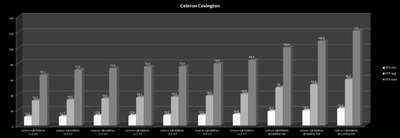

Celeron COVINGTON @233 MHz, CL2-3-3
avg 32.2
min 11.3
max 65.1
avg 33.3
min 11.7
max 71.9
Celeron COVINGTON @266 MHz, CL2-3-3
avg 34.6
min 12.8
max 73.6
avg 36.2
min 12.8
max 75.8
Celeron COVINGTON @300 MHz, @66MHZ FSB, CL2-3-3
avg 36.8
min 13.2
max 75.8
avg 38.4
min 13.3
max 79.9
Celeron COVINGTON @333 MHz
avg 40.8
min 14.4
max 84.3
Celeron COVINGTON @350 MHz, @100MHZ FSB
avg 49.0
min 18.4
max 100.6
Celeron COVINGTON @400 MHz, @100MHZ FSB
avg 52.8
min 19.4
max 108.8
Celeron COVINGTON @448 MHz, @112MHZ FSB, CL3-2-2
avg 59.4
min 21.8
max 122.0

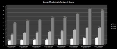

Celeron MENDOCINO @333 MHz
avg 54.1
min 20.1
max 109.9
Celeron MENDOCINO @375MHz, @75MHZ FSB
avg 60.0
min 23.0
max 122.7
Celeron MENDOCINO @417MHz, @83.3MHZ FSB
avg 66.4
min 25.5
max 138.2
Celeron MENDOCINO @400MHz, @66MHz FSB
avg 60.9
min 24.5
max 125.7
Celeron MENDOCINO 450MHz, @75MHz FSB
avg 68.5
min 26.7
max 139.1
Celeron MENDOCINO 500MHz, @83.3MHz FSB
avg 76.0
min 28.8
max 158.0
Celeron MENDOCINO 600MHz, @100MHz FSB
avg 87.1
min 34.6
max 176.4
PIII KATMAI @600MHz
avg 85.6
min 32.3
max 184.4

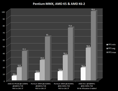

*** Pentium MMX system results:
AMD K5 PR166 @116MHz, RAS to CAS - 2T
avg 18.6
min 6.4
max 42.2
Pentium MMX @233MHz, RAS to CAS - 2T
avg 29.3
min 10.5
max 63.0
Pentium MMX @292MHz
avg 36.1
min 12.9
max 75.9
AMD K6-2 @500MHz, WRITE ALLOCATION ENABLED
avg 46.9
min 18.3
max 99.6

Conclusions:
Now we can see that a nearly maxed out Pentium MMX PC back in 1997 would deliver us just a slightly higher average performance than that of a PII Klamath clocked at 200MHz and a future upgrade to a 500MHz K6-2 CPU would guarantee a slightly higher performance than that of a PII Klamath clocked at 266MHz.
