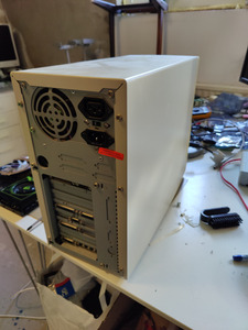

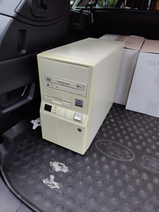

Just finished my 486 setup and wanted to share. This is my first 486 workstation class tower so im curious to get opinions on its benchmarks. Found it at an estate sale, it was setup as a full windows 95 workstation PC from Tangent, seemed all original. I stripped it down, cleaned it and rebuilt it as more of a DOS gaming spec 486. Kept as much of the original Tangent branded stuff as I could, anything I didn't I stored. Wanted it to be as era accurate as possible so no flash storage or anything like that in this one.
Specs are:
Lion Computers 486-SUPER EISA/VP Motherboard
486DX 66mhz
Full 1MB of cache installed
4 4MB 80ns sticks for 16MB total of RAM
Unbranded VL41C/V2 VLB S3 805P Card, upgraded to 2mb of vram
CT1680 SB Pro 2.0
Adaptek AHA-2742 EISA SCSI Controller
Seagate Elite ST43400N 2gb SCSI HD (It's massive! Works fantastic though)
Plextore Plex8 SCSI Caddy Loading CD-ROM
Sony SDT-5000 SCSI Tape Drive
IBM Model 1711 1.2mb Floppy Drive
Teac 1.4mb Floppy Drive
So far this seems like a happy combo. Doom runs very playable, even Duke 3D is playable. And the compatibility seems really great. Topbench scores it around a 200, with Turbo off its around an 80. Does the memory bandwidth seem fast for a 486 PC? Is that just because of the high cache amount? Also curious what are you guys doing for Dallas DS1488 Ramified Battery replacements? I have extra 12887 batteries but it wont boot with those. This battery came with it and for now it works good, but I have no idea how old it is and im sure it will need replacement eventually.

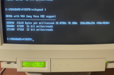

Almost 5MB/sec, but yeah that seems off.
On the other hand, speedsys is not at all a reliable measure of anything really.
Reply 6 of 12, by rasz_pl
While I agree its not the best measurement of graphics performance, it usually shows >10MB/s for VLB graphics. 4 is suspiciously slow.
FinalJenemba can you run VIDSPEED? hmm maybe 805 is that slow after all https://retronn.de/imports/hwgal/hw_graphics_ … _VLB_front.html

Sure I can run VIDSPEED. But it's true that most 805 VLB cards are not known for being fast. I didn't get it for its speed. I got it for its DOS compatibility and standard VGA performance. I also have a Orchid Weitek 9000 that I could have used that has MUCH faster gui acceleration and windows performance. But its legacy VGA performance is absolutely awful, and it had lots of bugs and issues in games. The S3 is over twice as fast in VGA DOS games and has no bugs, I expect its windows performance to be much worse but I don't plan on running windows much if it all on this build.
Reply 8 of 12, by Anonymous Coward
rasz_pl wrote on 2023-06-06, 15:30:
I generally agree. But there are definitely times when Speedsys is totally wrong. For example, it reports 486DLC-40 as 13MHz. And I think we're all aware of the crazy CPU score inflation when the FPU is absent.
For the record, with ARK1000 I get about 26,000KB/sec with the same motherboard.
There are some jumpers on the board that add VLB wait states. I believe they are not well documented. They should be near the VLB slots. I would compare a photo of your board to another one and set the jumpers accordingly. They also could be jumpers on the VGA card itself.

Ok guys I have some benchmarks for ya. Ran VIDSPEED with the L tag for VGA and it got a pretty solid score, up into the list with PCI cards. Pic below. Also ran the standard Doom shareware benchmark, default screen size, no sound, and got 31FPS. 31 seems pretty quick for a 486 so no complaints there, I should have run it before the ram upgrade to compare but I don't want to pull it all back apart now 🤣.
