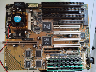

Hi everyone,
I've made a build from this GA586 ATS board. It's nearly finished but I want the quickest/easiest way to now add a mouse. I have free PCI and ISA slots.
It has an on-board 4 pin PS/2 header but it seems impossible to find anything to add here and I don't want to start a DIY wiring job.
Could I add a modern PCI I/O card that includes serial or PS/2? or would it have to be an ISA card? (serial connection is fine if I could use an serial to PS/2 adapter).
Any help appreciated.
Check if the manual for your motherboard has the pinout for the PS2 header.
If it does, it's very easy to rewire a generic PS2 bracket to fit there. You just need a multimeter for continuity testing and some DuPont wires.

You already have PS2 on board (J2), that means you cant add external PS2 controller (address conflict)
There are also two serial headers on the board (COMA COMB).
https://theretroweb.com/motherboards/s/gigabyte-ga-586ats

Thanks for the input. Honestly, I completely overlooked the fact that I had serial on-board. I just had tunnel vision trying to add a PS/2 port.
The adapters/brackets for PS/2 don't seem to be available in Europe. I've found a startech serial bracket though on Amazon though which looks perfect and then I will use an adapter to PS/2.
I think this is case closed. Many thanks for triggering the realisation.

no no noooo, there are many "standards" of serial pinout for those serial brackets. Just buying random one can end up with
-working mouse
-not working mouse
-smoke coming out of the mouse/motherboard
sorry for not warning you earlier 🙁
You will need to draw a diagram of GD75232 pins to header pins before buying/making custom Serial cable. Your best bet is buying one made not with a ribbon cable but individual wires going to the connector so you could easily swap them around.

Your board has a PS2 header, but the manual contains no pinout. If you want PS2, you could do what I did with my GA586-TX2.
There is a non-zero chance that the PS2 header on your board has the same pinout as my board, both being made by Gigabyte.
If you want PS2, you could fashion yourself a breakout adapter, but first make sure that the power pins are the same using the following method:
Let's assume your board has the same PS2 header pinout as mine. Refer to the pinout in the thread I linked in this reply.
Connect a multimeter to the GND and 5V pins, and check if you read 5V.
Now switch the probes and read the 2 same pins, but with opposite probe polarity. You should read -5V.
Keeping the one probe on GND, connect the other probe to the DAT and CLK pins. You should read around 0V.
If these conditions are true, then the power pins are the same between our two boards. At this point, you could try making a breakout adapter, connecting the power pins correctly, and determining the correct DAT and CLK order through trial and errror. If you connect DAT and CLK the wrong way around, nothing will break, but the mouse just won't work.

You have a 4 pin header. You need 4 pins out of the 6 on the PS/2 connector.
First, check what on the header is +5 V and what is GND.
Connect them properly.
The other 2 pins are mouse clock and mouse data.
You have 2 attempts. If your mouse works, you have wired them correctly. If not, change them.
As long as you don't mess up with the power pins you won't do any harm to mouse or mainboard.

He already told you how. Checking the 4 pins of ps/2 is much easier than serial and ps/2 is a vastly superior mouse interface anyway. Using a serial mouse on a ps/2 system is trifling.
Get a multimeter and find out which pin on the mouse header has a ~0 ohm connection to a +5 pin on the AT power connector (red wire). That's your power pin. Do the same thing with ground (black wire). Then look up the pinout of a ps/2 plug on wikipedia or google or anywhere and match them up. The other two pins are clock and data. You've got a 50% chance of getting them right simply by guessing. If not, no damage, just swap them around and try again. Simple as pie
