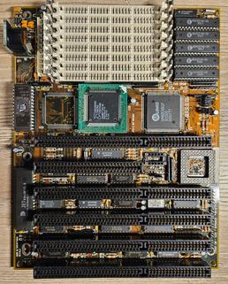

SInce you have not been able to identify the board, maybe it is a special OEM type that used only specific I/O cards due to bios and board design. Or the board has a major chipset issue......just a guess.
added: am suprised you did not post a picture of the board, most of us would have by now 😀

Will provide picture of the mobo. it wont provide any clues, thats why didnt do it already. A boring looking compact late 386 assembly.
Mostly psychological. If a help thread has no photos, people will ask. Secondly, maybe there is an obvious component missing that someone will spot (remember the missing ISA slot corner).
If there is, indeed, some problem with the motherboard which you are unable to find, I think using a bus mouse card with bus mouse would be the quickest option to find a workaround. In the mean time, I think it is a good practice to have some of the PS/2 KBC mod adaptors around for troubleshooting purposes.

I can do that. Will need that picture of the board to verify fitment though.
No one wants to read a book without pictures bro

In response to the request for picture, here comes nothing:
    456.01 KiB
    501 views

my ps/2 interposer should fit there, only catch is if you want to use socket(s) it will no doubt stackup too high for any ISA cards which have the "apron" at the back
