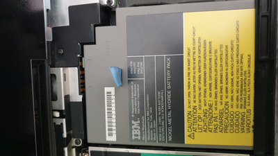

Hello
I need to buy a NiMH akku for my Thinkpad 370C
Or maybe can i change cells and refurbish at home?
Thanks any advice.

Reply 1 of 1, by Ryccardo
According to ThinkWiki the 370 series does have active electronics (unlike even its direct successor...) but it's probably old enough to not do "safety" aka profit optimizing anti-replacement tricks 😀
I'm afraid there's no real alternative to recelling either - too old and too niche to have 3rd party ones, even products such as the Sony PSP, with certainly a much bigger audience then and now, are not going well on this front...
