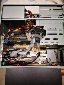

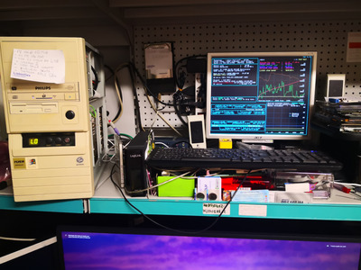

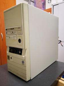

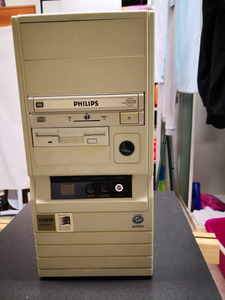

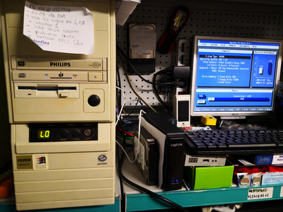

I present my pc "time Machine" (IMG_1 & IMG_2 )

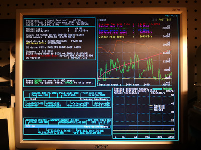

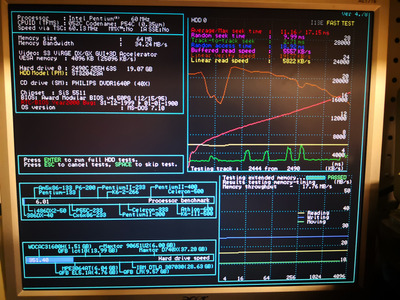

Well while I fiddled with the jumpers of the multiplier and frequency of this ABIT PH5 I
I realized that some positions were not documented and I decided to experiment!

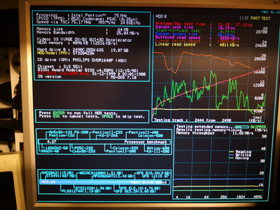

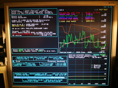

To my surprise I discovered that the mainboard frequency can drop to 25MHz !!!

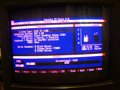

I found the following frequencies : 25, 40, 50, 60, 66, 80MHz. Chipping on the cake the turbo button attaches correctly and allows further reduction of performance!
These FSB values combined with the fact that the P166 supports the multiplier of 1.5X allow me to have a pc with cpu that starts from Pentium 1 to 37.5MHZ ! ! !

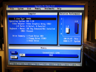

You can understand that I immediately thought that I could go down to 286 levels by playing with FSB, L1 and L2 caches, turbo slowdown and bios!!!

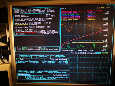

In fact, after several tests and changes also of the bios settings I managed to get to 1.41 in speedsys 4.78 and 1.8 in the sysinfo of PC-Tools 8.0 !!!
Keep in mind that my Olivetti Prodest PC1 based on NEC V40 with 512K of ram arrives in the PC-Tools at a score of 1.7!!!!

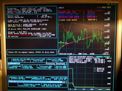

I then checked the stability of the P166 at 200MHz and it is perfect, it even remains functional for a while even at 240MHz (80x3) but I still have them to work even if I think the FSB may be too high.
So allowing me to range in the various "eras" from Turbo-XT to 286, 386, 486 and P1 up to 200MHz
I found the nickname "TIME MACHINE" appropriate.

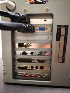

I then proceeded to create a simple system of switches to modify the FSB and the multiplier without opening the cabinet (obviously with the PC off) of the computer.
I attach some photographs of the switches and tests at various speeds.

Reply 1 of 17, by Legno74
More photos of speed tests and comparison with the Olivetti PC1
I will post (I hope soon) an article about my superpumped PC1 !!!
Reply 2 of 17, by Legno74
more photos

Omg, moving jumpers to switches externally, that is so brilliantly simple, that it's crazy that it's not something everyone does or did back in the day before BIOS setting of speed ... definitely on my to-do list, the day I find time to tinker with some of my retro stuff 🤣

i have jumpers relocated outside on several of my builds. search for 'dupont' connector and you can get premade wires of various lengths with male and/or female ends. i actually just use the female connectors then take a jumper block and remove the molded plastic bases to get the header pins for the outside.

Reply 16 of 17, by HanSolo
A friend of mine put the switches to the front into a drive bay-cover in his Pentium 2 retro PC to select the CPU multiplier. (German but you'll find it in the pictures)
Reply 17 of 17, by Legno74
HanSolo wrote on 2023-06-26, 14:46:
Very nice!
I had also thought of a frontal solution. But I already had these switches and I preferred to put them on the back because they are ugly 🤣🤣
