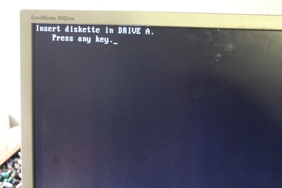

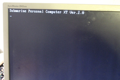

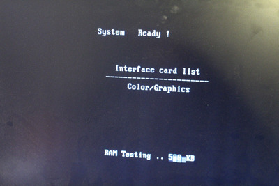

First post, by Robin4
file.php?mode=view&id=166891
First screen
file.php?mode=view&id=166892
Second screen
file.php?mode=view&id=166893
Third screen.
Problem is, the first screen goes to fast away, so the ram count is hard to see in 1 second. (can this be slow down, or do i need to use a slower EPROM) using an Mitsubishi M5L2764K right now)
Second problem is on the second screen says `Submarine Personal Computer XT` I want to change Submarine in XPC
Reply 2 of 4, by Jo22
Hm. Can't be a few NOP instructions be added simply?
Reply 3 of 4, by jakethompson1
First step is to get the BIOS up and running in an emulator so you can test your changes.
For changing strings, you can use a hex editor. You can only do in-place replacements of existing characters though--you can't lengthen or shorten the string.
However, if you make any changes to the BIOS, you must either update the checksum or locate the checksumming code and disable it.
Reply 4 of 4, by mkarcher
jakethompson1 wrote on 2023-06-25, 02:50:
ROM BIOS piracy was a big thing in the Turbo XT era. Some far-east clones shipped with BIOSes that were taken from original vendors. To combat ROM privacy, many BIOSes of that era contain extra checking code (sometimes even multiple copies of it at different location) making sure the copyright strings are not modified, and otherwise crash the system during boot.
Robin4 wrote on 2023-06-24, 16:22:
And this change might trigger the ROM piracy protection, so be prepared for some extra work.
