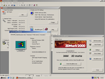

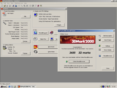

Hi, your post intrigued me so I decided to do a couple of tests.
I have a pc similar to yours -
Pentium 3 700MHz
Asus P3V4X with 512MB PC133
NVIDIA GeForce 2 ULTRA VGA
and 128GB SSD
I tried PC Mark 2000 first with SP3 and then with SP4
As you can see the results are comparable.
So I think it's a problem generated by the too new VGA set / Heavy drivers, chipset etc
Not an issue related to SP4
I hope it can be useful to someone

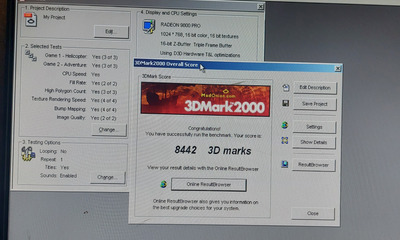

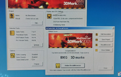

Reply 3 of 3, by Topaz
Ran 3dmakes 2000 and 2001
