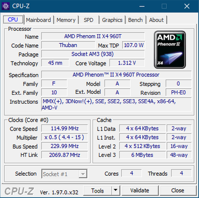

Reply 12 of 12, by Falcosoft
DrSwizz wrote on 2023-06-29, 19:44:
The Phenom II only goes down to 800MHz or something like that.
This is not true. The Phenom II can have a 0.5x multiplier (with the help of dividers):
Re: CpuSpd - A Hardware Based CPU Speed Control Utility for DOS/Win98 Retro Gaming
So assuming a default 200 MHz base clock it can go as low as 100 MHz.
