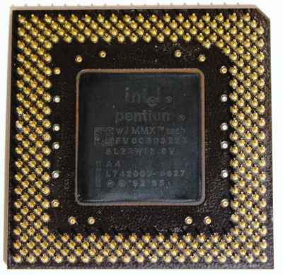

The only SS7 board I have in a working condition is a GA-5AX Rev 5.2. I have a handful of MMX chips, so I decided to try them out and see which one was the fastest, the slowest, etc, but there were some surprises awaiting me. Take a look at this one:
536.65 KiB
1365 views
It says FV80503233 / SL23W / A4 / L742003-6627 but that's supposedly a 200MHz CPU according to online sources... No matter how hard I try to clean it, it always looks dirty, text is very very dim. I think this one has been relabeled, with a rubbery substance. What do you think?
It didn't post at 3x100 3.3v. Then I found out that it doesn't even support a 3x multi! (for some reason 3 = 3.5), so it's either 2 or 3.5. It was stable at 290MHz (83x3.5 3.3v).
If this was a relabeled SL23W (200MHz), isn't it supposed to support a 3x multiplier (66x3)?

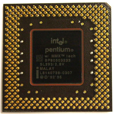

Finally, this is the fastest one I have, an SL293, BP80503233, which runs stable at 3x100 3.0v.
571.03 KiB

It says "SL27X" but that's supposed to be a PPGA chip... It doesn't even do 233MHz with 2.8v, it needs 2.9v to be stable. So I think it's a relabeled 166MHz CPU. What's interesting is that it supports a 3.5x multiplier. Do all 166MHz ceramics support that multiplier? Are all the CPUs that start to "peel off" actually fakes? I think I have another one somewhere, but an early Pentium (non-MMX).
I also found that I have an authentic ceramic MMX, I think it's the fastest one there is, an SL2S9. I read that it's not that common to see a 200MHz MMX in a ceramic package. It's a lousy overclocker though and works only with 2.5x and 3x multipliers.
