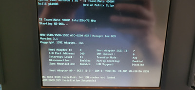

Hi I obtained a Texas Travelmate Docking station.
It has a SCSI CD Rom which is seen by MS Dos but I can't read disks. I've attached some photos of the screen.
Also I can see underneath there has been a high temp causing a melt to the casing.

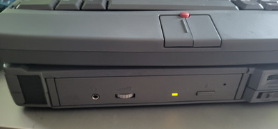

    Light stays on, never goes out

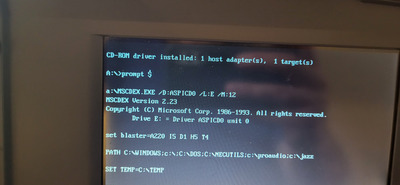

    Everything loads fine

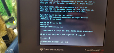

    Won't read e:

The device seems to be detected on boot. Right?
So the PC has a CDROM drive on boot and is recognised by the scsi controller (and that controller is proven to work?)
My next test should be to try an alternative scsi cd rom but they are quite pricey, this would probably help confirm the scsi controller is good.
Some communication is definitely taking place as via the dos scsi drivers, the exact cd rom make and model are returned.
