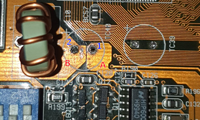

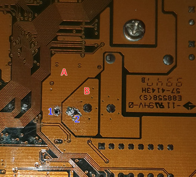

Reply 26 of 49, by kinetix
Well, I'm pretty screwed.
I soldered the capacitors that I had removed and energized the board. The monitor briefly went from "no signal" to wanting to show some signal, but I power off immediately when I remembered that I had to check something. I didn't realize if it had shown anything on the screen. When I turned it on again, there was no response, but I thought I heard a very faint creak on the board a couple of times. I tried a couple of times without result.
I removed the capacitors again (arrrgh) and checked the soldering point. Once again I had forgotten to verify the welding points. Now the rounded point, which I assumed had no contact with the upper line, is giving me continuity with it. It seemed to have an almost invisible solder joint. I dedicated myself to cleaning the contact, even using an injection needle to scrape and make sure that the solder and the metal of the pass-through did not touch the vein.... but it continues to give me continuity. dam!
I really need certain information about which veins contact the legs of the capacitors, which veins in wich side touch each hole.
do the round point (1) contact the back vein (A)? and the front side?
do the square (2) contact the veins (B) in both sides?
I leave the reference images.
remember it is a rev 2.2

Reply 27 of 49, by asdf53
From your photo it does not look as if there is a connection between "1" and "A" on the top side. Switch your multimeter to resistance mode and measure the resistance from the solder hole to the exposed metal in the top plane "A". If there is a short-circuit, you will get a very low resistance. If there is a resistance of 10-50 ohms, then it is just leakage current that occurs across the other capacitors that are still in the circuit.
If there is a connection, the easiest way to clean it is to apply flux to the area, then gently go across the area with a clean iron tip to suck it up. Keep dwelling time short and the temperature below 380 to prevent further damage to the solder mask.
And I forgot to mention: If "A" is a ground plane, there will always be a connection between "1" and "A", regardless of a possible solder bridge, because "1" is also connected to the ground plane on the bottom side.
Reply 28 of 49, by Nexxen
If the issue is if 1 makes a connection to A, and 2 to B,
take a sharp tool, scratch some solder mask from A and B (until you see the copper) and test it for continuity and resistance. Simple as that.
Flux + solder braid and clean the area.

Reply 35 of 49, by Nexxen
kinetix wrote on 2023-09-27, 23:21:
Nexxen wrote on 2023-09-27, 21:33:
2 is connected to B, to coil L10 and mosfet Q8.
1 to A.
1 to both sides As?
Dude, 1 is connected to ground... 😀
The + just next to the cap circles indicates polarity and means "Voltage in" and is connected to C42 to 46 (the capacitors next to the cpu socket)
Q18 and 17 are connected to that huge plane and are GND. For that lead of the capacitor to be connected to ground is correct, otherwise you'd have a huge kaboom!
Relax and be done with this. It's all OK.

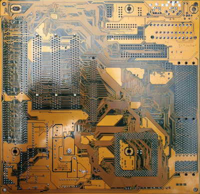

Reply 37 of 49, by kinetix
Nexxen wrote on 2023-09-28, 00:50:
Again, could you upload high definition pictures of your motherboard.
Top and bottom, thanks.
here you go.
I had to limit resolution, quality and filesize to what Vogons allows.
I horizontally flipped the image of the backside so that it coincided with the topside and was easier to analyze.
The green capacitors are the ones I changed, in addition to TC39 and TC40
It is interesting that the C116 capacitor appears to have never been included on the board. In the images that I have found this capacitor exists, but apparently it was not included in this board when it was manufactured. The solder points have tin but the "drop" and the holes are too regular to have been removed latter.
mmm, maybe I'll send to "theretroweb" some better images than the ones they have of this motherboard
    1.85 MiB
    715 views
    1.73 MiB
    715 views

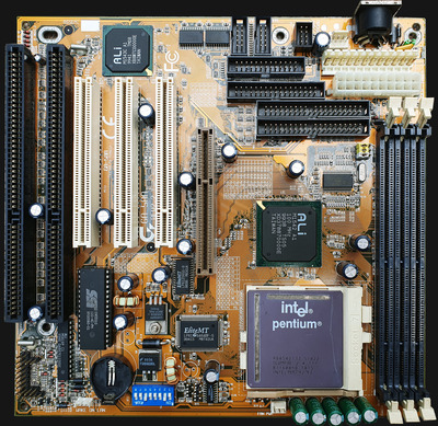

well, it boot!!!
right now!
At the beginning, after putting in the last capacitor it didn't start, no image.
I checked the configuration switches (according to the stencil on the board) and tested at 3.3 and 3.4 volts. nothing.
tried another Pentium 133. nothing.
I changed the memory stick, et voila!!
The bad thing is that it is only 16MB (16MB PC66). The others I have and tested with are PC100 and PC133, in theory compatible, but either they are bad, or the board doesn't "like" them. I thought the higher speed ones would work at a lower speed. Maybe the pentium133 is the culprit and they do work with a CPU with a higher FSB (ie the K6-2/450 I got with the board). anyway, I have to test them on another PC (a PIII Compaq Deskpro EN that I have here and recently restored). everything else I have available are 72 pin FPM and EDO sticks.
I'll look for some additional compatible ram sticks.
the bios is the 1.3 version, so maybe, if in the end it works correctly, maybe I will update the bios to its latest stable version.
Now I´ll continue working on it because it is stuck in "Checking NVRAM". maybe is that ramstick, or the bios. keep working
mmm, it doesn't have a jumper to clear the CMOS
