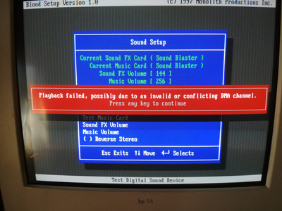

After this, i can hear something on some games but not all: Duke3D and Blood says there is a DMA conflict on Sound FX (i can hear music tho), no matter what kind of sound card type, DMA, IRQ i choose. Jazz Jackrabbit is mute, Keen just recognize PC Speaker and so on.

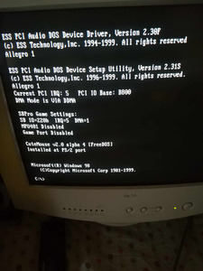

this is the situation after booting on real dos with expanded memory, everything looks working according to it, just like on previous more modern Asus board.
but is not really working like i was truly hoping 🙁 some few games will work, the others not i had no time for test all thousands i have on, but is clear a not 100% safe situation but strange at same time:
Keen 4 for example works, music is there and the fx effects despite they sound bit choppy you can hear them, but most of other games setup when they try to test the card just freeze like in Indycar 2.
One last funny strange thing is for example in Blood (Duke and all Build engine games too) that the music works as it should be, but no way to get any Sound FX card because no matter sound card type and IRQ/DMA i choose i get this:
1.66 MiB
1475 views
So i don't really know, is like the card works in half, surely i can miss something (im using the exactly same hdd of previous working PC and same ess drivers) or maybe the Via Apollo chipset on this mobo is bad.. on basement i har other two socket 370 mobo's, but i don't know it they work and as far as i remember judt googling them, guess what? both have same via apollo chipset of my current one... 😅

just tried selecting bot 16 bit and 8 bit under sound settings in Blood\Duke3D but that damn red error shows up always 🙁

Build-based DOS games uses the ASS (Apogee Sound System), where the HDMA and 16-bit mixing only has effect on the SB16, GUS, Ensoniq SoundScape and PAS16. Any other sound card will only use 8-bit mixing regardless of the settings.

Interesting, it seems you're using the driver for the ESS Maestro with you ESS Allegro. I'm not too familiar with those cards and how similar they are, but that could be part of the issue. I quickly looked at vogonsdrivers.com, but didn't find any drivers for the Allegro there. Phil did a video on the Allegro as aaronkatrini mentioned, so maybe he has the drivers on his website as well.
There might be a .SYS file in the driver package as well (there is for other cards), that you could try loading. From my experience with the Solo-1 the computer crashes if you load the .SYS driver after EMM386.EXE, so load it before. With my setup I didn't need this part of the driver but maybe it will help in your case.

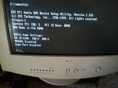

Also in your screenshot you can see the driver selected DDMA for the legacy DMA (as in: used with ISA cards) emulation. There is probably also a TDMA and maybe a SB-Link option. The first one you could also try and maybe have a better result. The kind of emulation is actually dependent on the chipset you use and some combinations work better than others. That's probably what you were referring to when you said ESS and VIA were a good match, now that I think about it from this angle.
Others probably know better if DDMA or TDMA is supposed to work better with your chipset (which one is it by the way?), but with only two options it's definitely worth a try.

Reply 13 of 23, by VenomSpark
etXzat wrote on 2023-10-10, 17:20:
VIA VT82C694X (Apollo Pro 133A)

i've tried swap the .ini file you provide with mine, but no luck 🙁 it is always on DDMA mode, looks like is stuck somehow or this chip is a very nasty b*stard (never been huge fan of any VIA chipsets, expecially this one that gave me other troubles with AGP 4X)
132.96 KiB
1208 views
as you can see the message are always the same, which make it looks like everything loaded up fine but sadly not. I super fast tested some games and for example Jill of The Jungle runs perfect: sounds and FX are there.
No luck in DOOM 1 & 2, i've tried Epic Pinball and Jazz Jackrabbit and despite looks like the game recognize it (i can change volume) and setting the right IRQ and DMA (5 and 1) on setup, the games are simply mute, no sounds at all. Same goes for Duke and Blood but i am sure other games will have this issues, is a sort of 50\50 when of course just the minority works, and this is useless for me 🙁
here's a video fast example of what happens on Build games:
https://www.veed.io/view/it-IT/f82aaf24-ef0e- … aeae614a?panel=
is like the music is fine, FX effects are not (tried every choice possible), which i didn't had with previous motherboard and i finally had chance to look the model!
is an ASUS P5VD2-VM\V which, ironically, mounts a VIA VT8237A chipset. With this mobo\chip the same exactly card with the same exactly driver i provided worked 100% on pratically ANY game without a single issues, even on Another World (!!!) but sadly is half dead (maybe a RAM slot issue) so i only have this other Asus as second option, which is even older so i was almost going super sure it would have worked fine, but gives me all this trouble 🙁
etXzat wrote on 2023-10-12, 02:26:
Do you have a link to the driver from Phil's site? The one I found was missing the .INI file completely and was only usable once I wrote my own with the info in the other thread in a hex editor.
sadly i can't really remember where i got that driver, but it was a .RAR file with\for lot of E19xx models, including mine. I can upload the whole rar if needed.
