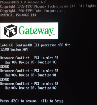

Hi guys,
I picked up a new-in-box Belkin USB2 PCI card (with an NEC chip) and tried installing it in my Gateway E-4200. During POST I get a number of "Resource Conflict" errors (see screenshot) - I've not seen these before, as far as I remember.
Other cards in the PC are an ISA sound card (Trust card with OPTi chipset), PCI 3Com NIC, AGP Voodoo 3 2000. I may try removing the 3Com card as I haven't used the Ethernet in a long while - perhaps that will "free up" resources.
I had a look around in the BIOS for anything useful, but there's not much in there. I notice the "Plug & Play OS" mode is set to disabled, and have not yet tried messing with this yet. I dual boot Windows 98 SE and DOS 6.22, and I think that may be why I had it set to disabled.
Is this a "You have too much stuff" error, or maybe a "You need to be using Plug & Play OS and let Windows figure this out" kind of error. Or both? Or neither? I'd appreciate any thoughts please =)

Reply 1 of 9, by Horun
Yes try removing the NIC and put the USB2 card in that slot, you could also first try disabling the onboard USB as a test to see if the two are not compatible (same memory range or other resources)...
Usually you do not need to change the PnP OS from disabled on DOS/WIn9x boxes from my experience....
Reply 2 of 9, by WildW
Good advice, thankyou. I removed the NIC but I still had to move the USB card to the 1st PCI slot before it would boot without the same resource conflict messages.
I was able to install the USB card's drivers from CD and then NUSB to allow USB mass storage to work in Windows 98SE. This is working but I'm now seeing Windows freeze pretty regularly when I'm using the USB, e.g. I was able to copy an 80MB file from USB to hard disk in about 10 seconds, but when I started to copy another file I got a freeze before it got started. Mouse and keyboard (PS/2) stop responding and I have to just power off. I'm willing to accept this is just Win98 being Win98 and just live without it I guess. I'm considering trying out Windows ME so perhaps that will fare better.
