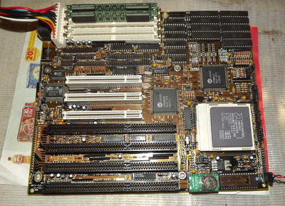

Hi everyone !
Please help me I might have toast this 486 motherboard after I removed the Dallas chip and installed a socket
I wanted so much this board as I dont have any other 486 board so advanced with PCI and onboard IDE 🙁~
The motherboard is unknown maker but seems to be similar/compatible with ECS UM8810P-AIO ...
The board worked and posted but it had one of those Dallas soldered directly to the board and the BIOS didn't allow to proceed booting as it didn't remember the hard drive settings...
All I did was disorder the chip with a desoldering station and then very carefully solder a socket
I was very careful and after the solder I went and checked every connection on the pins to see if they were properly soldered and all of them had continuity
Then I installed a "necroware" Dallas replacement that is working and works on other systems
When I turned the power... nothing...
then I replaced it with the old Dallas and it did boot alas it seem to be a bit unstable and/or crashed... I don't remember
I tried it a few more times .. the new chip never booted and the old Dallas booted.. until.. even the Dallas stopped booting
I tried with different dead dallas and another new "necroware" replacement and nothing

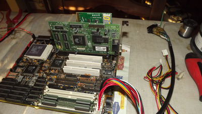

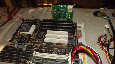

The POST analyzer stopes at POST code "07" or "D7" I'm not sure, but I think it is zero-seven ... it is an AWARD BIOS
The POST analyzer starts at C1... then jumps to some number/s very fast, then C3 and is stuck in C3 for a few seconds and then jumps to "07"
I know the boad is not totally dead because if I remove the memory modules it does beep continuously and the post code stays at C1 or C3.. I don't remember
I have tried everything, different RAMS, different graphics cards
I even think I cleared the CMOS jumper, not sure because I don't have the schematic but I cycled some of the nearby jumpers
Did I fry the chipset ? 🙁~
I don't recall doing anything out of the ordinary, I didn't short anything, I didn't change any jumper settings
I tried reseating the chips several times
I desoldered and re-soldered the socket and nothing 🙁
Please anyone help !

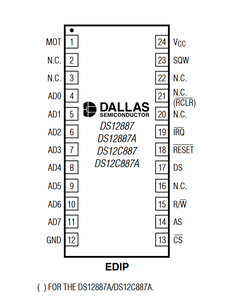

Reply 5 of 14, by Thermalwrong
It's unlikely to be a damaged chipset since it's going through many normal POST code messages before settling on the RTC / CMOS interface (NVRAM?) error message. Also when working on these things, I recommend keeping to where things are already known to be different from factory condition - at this point you've only worked on the RTC module area so that should be the only possible area that might damaged right now. You've confirmed this mostly since the board still gives most POST codes, if it was sticking on one then that could be a bigger problem, but since it's cycling through normal codes (C1 etc are pretty late ones) and settling on one error message then the chipset, BIOS and CPU are still mostly doing what they should.
You don't need an oscilloscope to test at this point - just check with a multimeter whether each of the through hole pins connects to the trace it's supposed to, looks like there's a few all in a row on the back side of the board. They look like they're the data pins for the RTC module, if one bit is off it all falls over (and if one bit is accidentally joined to another data bit through a soldering error, that can make the whole system break):
65.64 KiB
849 views
Looks like from where pin1 is nearest to the adjacent ISA slot, the AD0-7 pins are those data pins and they seem to run into a group of those traces on the back of the board, so checking those is easy.
Just verify that each of the pins connects to where it's supposed to be going - the nearest VIA. What's happened to me enough times now (and may be your issue) is that when a component is removed, sometimes a little bit of the via that connects that hole to the PCB breaks away and the hole then has no connection to the rest of the circuit even if it looks like it's fitted
In which case I usually scrape a bit of the soldermask back on the trace going to that pin and solder the pin and that uncovered copper trace together. It doesn't need much and won't look much different from factory condition as long as you're careful to only remove the solder mask and leave the copper trace. It's got things working a few times where I couldn't actually find which trace I broke specifically, after desoldering and resoldering components.

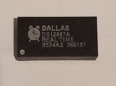

This is the original RTC in place ... it is the 12887A very common and replaceable by the necroware design with the Benchmark bq3285s
But that is irrelevant as as I said I reinserted the original chip that was working and the board wont boot with any of them

Ok the board is booting
very weird, I could only boot it by removing all jumpers that set speed... JP5, Jp7 and Jp8 .. all open ... it booted saying it is 50mhz even though the CPU there is an AMD DX2 80mhz
The jumpers were originally set as JP7 and JP8 and it was supposed to be 80mhz or 100... the guy that sold me the board told me that the CPU was managing to overclock to 100, I dont know if he left it at 100 or back to its original 80mhz... but again... the board was booting before I replaced the RTC
I also managed to boot the system with jumper JP8 set and it would say it is a 66mhz , also one time very briefly it booted saying it was 100mhz with JP5, JP7 and JP8 closed
but it was only once and now every time I retry it wont boot.. all other jumper configurations don't work
it is very irregular and strange behavior ...
I tried it with the old Dallas and it booted and in the setup the clock wasn't moving, after POST before booting it would crash
I managed to boot it with one of the necroware dallas replacements and it managed to hold the settings and clock and boot from the hard drive
but the speed settings are very very weird I didn't touch them and it was working...
maybe the CPU is damaged I dont know
I will study the jumpers and try to set it properly to an AMD DX2 at 80mhz .. lets see
Boy this board is LOADED with jumpers .. ahhh good old days
