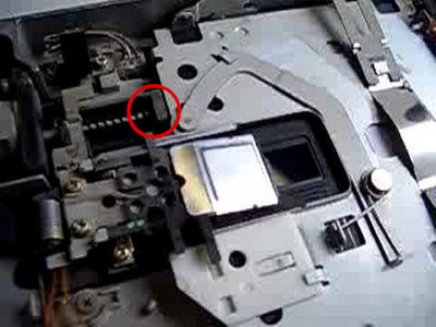

Reply 3 of 20, by dominusprog
Clean both rails and apply lithium grease.

Reply 13 of 20, by dominusprog
It is not a matter of minimizing friction but restraining the head assembly to the rail.
Aztech Pro16 II-3D PnP ❇ 8.4GiB Quantum Fireball ❇ Win95 OSR2 Plus!
Reply 15 of 20, by dominusprog
boby wrote on 2023-10-26, 16:14:
dominusprog wrote on 2023-10-26, 14:40:
But I don't have any lithium grease with me atm
Clean both rails with alcohol and add a little bit of lubrication at the end of the rail connected to the motor.

Reply 17 of 20, by dominusprog
boby wrote on 2023-10-26, 18:19:
dominusprog wrote on 2023-10-26, 17:01:
What can I use instead of lithium grease? I have WD-40 and cooking oil/grease only 😀
Add a little bit of cooking oil to the end of the rail connected to the motor.

Reply 18 of 20, by boby
dominusprog wrote on 2023-10-26, 18:43:
I have cleaned old grease from the rails, put some pig grease on the rails and cleaned the heads again with IPA. It formats the diskette now without problemsas, as well as, creates a system diskette and boot from it. The only thing that fails is to copy from the diskette (command.com file) but that can be something else.
I would say this is solved. Thank you all!
