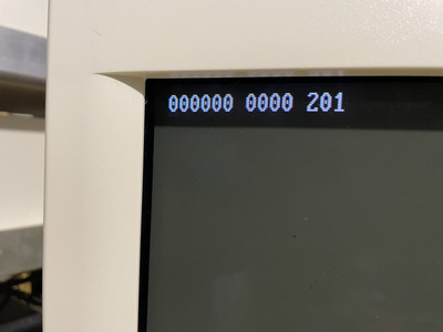

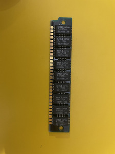

i have 1Mb originally using the sim with 9 chip. i have also 4 simm with 3 chip seen in photo but when i install i only receive this error… someone know why?

It seems the issue belongs to the first bank, perhaps a broken solder joint?

Reply 2 of 12, by pentiumspeed
PS/2 286 only supports 256K simms. Is this model 50?

Reply 3 of 12, by AlessandroB
Is a Model 30-286.
Reply 4 of 12, by pentiumspeed
Supports up to 4MB on board.
But being IBM as usual used non-standard modules, you can use 3 chip or 9 chip 1MB modules but have to modify them.
Success! Convert regular SIMMs into IBM PS/2 proprietary SIMMs

Reply 8 of 12, by BitWrangler
Magic numbers for 1MB SIMMs IBM P/N 30F5360 IBM FRU 74X8637 or do this mod... http://john.ccac.rwth-aachen.de:8000/misc/ps2cache/

mmmhh.. I read your link well, it doesn't seem like a difficult job to do, the only doubt I have.. if you look at the photo of my simm with 3 chips (which are the 1 MB ones to be modified) they have 2 identical chips and a different one... why? Is this change also valid for them?
Reply 10 of 12, by pentiumspeed
3 chips is same way as 9 chips, just the two chips are 4 bits wide each for 8 bit data, and third chip is 1 bit wide for parity.

Reply 11 of 12, by AlessandroB
pentiumspeed wrote on 2023-10-26, 21:59:
Cheers,
yes, but in the modification scheme the connection of the rightmost chip is modified, but my rightmost one is precisely the one different from the other two.
Reply 12 of 12, by pentiumspeed
The pinout of SIMM are same regardless of chips, what you need to change the routing from the pinout not the chips as shown on the photos.
