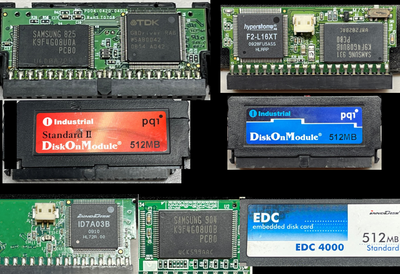

I like IDE DOMs because they make for a very clean looking build but there are a couple things to remember:
  • They have clasps that attach very firmly and can crack the plastic guard rails around the IDE headers if you are not careful
  • If you have a Pentium or newer system and want to do speeds faster than ATA-33, you need to either ground pin 34 or attach with an 80 connector cable
  • If you are doing the faster speeds, the larger capacity DOMs with multiple flash chips often seem to have higher max throughput capacities
  • The guts are usually simiar to an industrial CF, but like industrial CFs, there's a lot of different guts that can go in there. Here's photos of 3 recent ebay purchases:
1.25 MiB
480 views

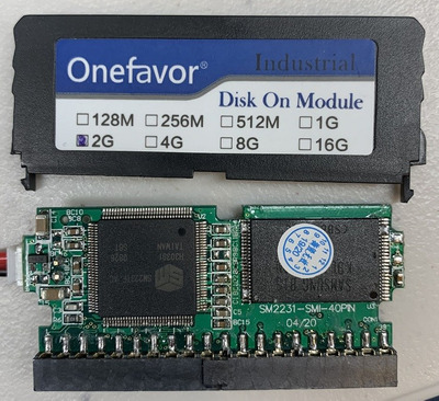

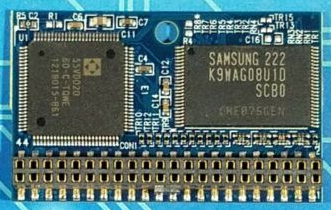

And here are some older ones…
146.42 KiB
474 views
64.75 KiB
474 views

Out of all the different controllers pictured, in theory, the EDC 4000 / Innodisk looks the most interesting with the wide range of supported IDE modes and support for wear leveling. I'll test them out some time next week.
https://www.innodisk.com/en/products/flash-st … c_4000_vertical
https://www.design-reuse.com/news/4650/hypers … y-solution.html
https://www.jotrin.com/product/parts/W5AB0042
https://www.greenliant.com/dotAsset/39671.pdf
Cant find out much about the Silicon Magic SM223TF AC
