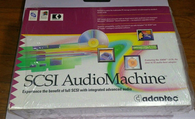

The manual is a bit sparse on Audio setup, yeah any other tips you have would be good. Did find a picture of the box and somewhere read it is SB Pro compatible.
    245.17 KiB
    237 views

I threw it up on Archive.org. I'll put this image against it as well.
