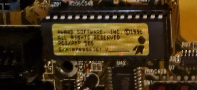

This is a picture of my chip. Can I replace it with any Award "PCI/PMP 586" or are there other things to check?
/me love my P200MMX@225 Mhz + Voodoo Banshee + SB32 PnP + Sound Canvas SC-55ST = unlimited joy !
Reply 13 of 34, by technokater
You need the part number of the chip, which is unfortunately below the sticker. The sticker is just kind of a proof-of-license for Award BIOS but says nothing about the actual chip type.

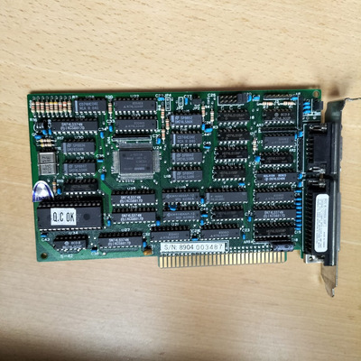

Luckily today I was able to locate my old ISA Hercules video card (picture attached). If this works at least I will have some visibility.
I still have a few things to try before giving up. First of all I did prepare the floppy but based on a MS-DOS 6.2 boot image. I changed the AUTOEXEC.BAT to trigger the Awdflash but forgot to remove the CONFIG.SYS so maybe that is creating some kind of issues (I know that awdflash needs quite a lot of memory).
I'll keep you posted.
