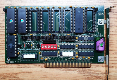

From the Promdisk IV (I got one) I have been able to find some documentation and software. but for the PCD-890 (I got 2 of this) only some software.
I haven't tried the cards yet, but I read the chips both had in it. They contain MS-DOS 5.0 and some industrial software.
With the soft and documentation of the PROMDISK IV I will be able to use it (it is a somewhat newer card, it seems), for that I am accumulating flash chips (I don't have an ultraviolet eraser).
But I would like to be able to do the same with the larger cards, because the total larger capacity you can get (12 MB vs 4 MB the smaller card)

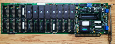

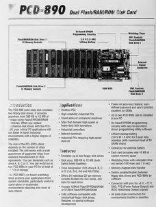

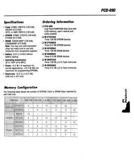

I would appreciate if anyone has documentation for the PCD-890 card to share it. I am attaching the only thing I have found about, basically just one specifications sheet.
And pics of both cards

It appears per the documentation, that you can have 2 of theses in the system at the same time. One could be sporting EEPROMs, and the other could be sporting SRAMs, for a bootable romdisk, and a working ramdisk, C and D. They seem to use a standard lithium primary battery for parallel SRAM operation.

I already have that one thesis. but I had only seen the specifications of the card, which are at the end, in the annexes, those are the images I attached . I didn't notice that part of the text, hehehe

Yes, and it is a very interesting way to use them.
For now I have enough 128KB SRAM compatible chips to fill one BANK and UVEPROM to fill the other bank of one of the PCD-890s, and partially the other card.
I can also fill part of the smaller card.
but what I find difficult about UVEPROMs is to erase them. I'm thinking about building an UV eraser.
That's why I'm looking for enough compatible FLASH PROMs.
