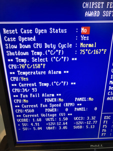

I thought I'd also mention this. The BX2000 PC speaker goes off like an ambulance (siren) so I have it permanently disconnected. I believe the reason why it does that it because it cannot detect -5 volts. There is no way to ignore the -5v rail in the BIOS.
I suspect no one else has come across this issue because they are running old PSU's with -5v with this motherboard. See the motherboard voltages in the screenshot below.

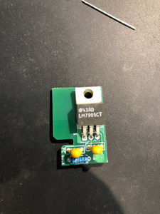

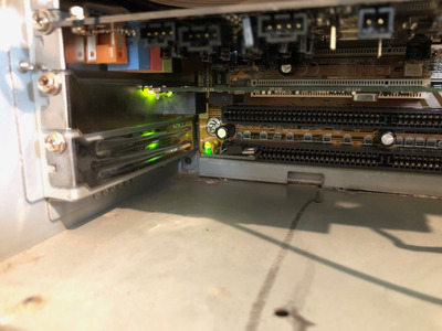

Voltage Blaster or a DIY alternative.
Thanks for the idea. I had a couple of Voltage Blaster Mini's sitting around so I built one up and installed it in the BX2000. -5v now showing in the BIOS and the PC speaker isn't going crazy anymore.
I played Doom 2 for 1 hour and no shutdowns. I wonder if the alert in the BIOS constantly going off might have been causing some issue over time? It's a long shot but it's my only guess at the moment 🤣
I'm not taking this has a win yet because it seems to be a bit random but Doom has never lasted this long before. I'll keep testing over the next couple of days.

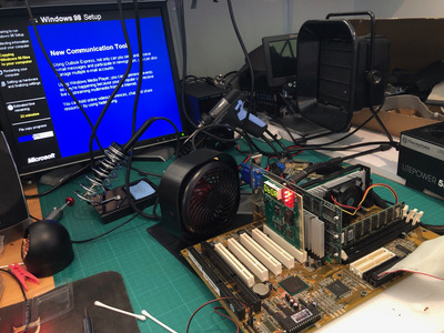

I managed to grab ABit AB-BE6 off eBay being sold as "for repair". The motherboard ended up being in perfect condition, no issues at all or bad caps. Just needed a BIOS update (it was on the original factory BIOS).
Going to swap the BX2000 with the BE6. If Doom stops powering off the machine then it's either the BX2000 motherboard (re-cap needed?) or the incompatible between the BX2000 and Voodoo 3. I could just swap the Voodoo 3 for another card to test but...I like taking the painful route 🤣
