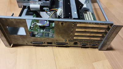

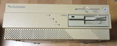

Front of the computer:

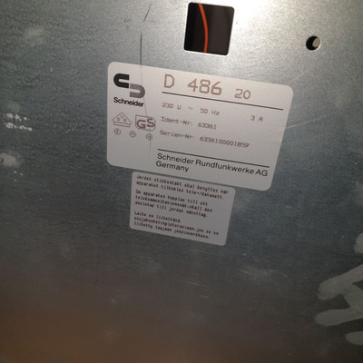

Bottom with model/serial:

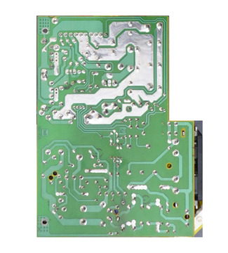

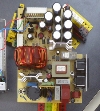

PSU top and bottom view:
573.19 KiB
300 views
412.48 KiB
300 views
Please note that the bottom is flipped to match the top side. Tried to follow the traces here. Please also note that there are two daugher boards involved. Both are sticking vertically out of the main PCB and are therefore not good to see.
One is located near the large cap on the high voltage side of the PCB and holds the controller chip and some passives. The other one is just below the mainboard connector and has an analog comparator on it. I assume it is part of the regulation circuit and/or generates a power good signal. I'm not allowed to add more than 5 pictures to this post but will supply additional pictures if needed.

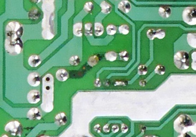

Reply 2 of 8, by dura-zell
Hi
actually I'm not sure.
When inspecting the pcb I did checkfor continuity and everything was fine. To be sure, I added a wire between the solderjoints.
On the other side of the board are I beleive an inductor, -12V regulator and an potentiometer.
greetings
dura-zell
Reply 3 of 8, by Deunan
dura-zell wrote on 2024-02-24, 18:27:
Desolder all nearby electrolytic capacitors, this is usually a sign that one of them leaked it's fluid and corroded the trace. This would not be obvious from the top side if the leak was slow, along the lead, as this is single-sided PCB and the holes are not plated so any fluids tend to easily wick into the holes. If in doubt replece the capacitor. The secondary side of SMPS is usually where caps would age quickly and once the ERS goes up it's a runaway situation - temp. rises and the cap will either dry out or leak, or sometimes even vent. If this was 85C then think about 105C replacement. Preferably low-ESR but it's not critical (as on mobo CPU rails), any decent modern electrolytic will work fine.

Reply 6 of 8, by Jo22
Is that same PSU as used in the Tower AT model?
I'm asking, because I've essentially rebuilt that thing a few years ago. 😁
It took some tome, but it was worth it. Replacing the diodes by bigger ones (4007?) helped.
My MOSFET was broken, too.
Other than that, my memory is a bit foggy.
I vaguely recall that the negative voltage was being created in a very interesting way.
Essentially by using a trick circuit, hah. 🙂
The little daughter card had some "power good" circuit that remote-controlled the PSU, essentially.
Oh well, that's all that comes to mind rught now.
Reply 7 of 8, by dura-zell
Good Morning
Unfortunately it is not the same. I could only find one picture on a german site (http://retro-net.de/?id=73 / Click on the pictureof the system and then "right" two times). It looks a bit similar with the daughterboard but still quite different.
The negative Voltage is created with a regular ST L7912CV and the rest of the circuit looks more or less "run of the mill" - seems that they did nothing "naughty" here. I think I'll remove the IC later today and also check a bit closr on the PWM chip. Obviously I can replace most parts "just like that" (except for the transformers) but if possible I would like to find the cause of the issue.
greetings,
dura-zell
Update: removed the Cap and -12V regulator and had no change in behavior. Waiting now for the new Cap before reassembling and testing again.
