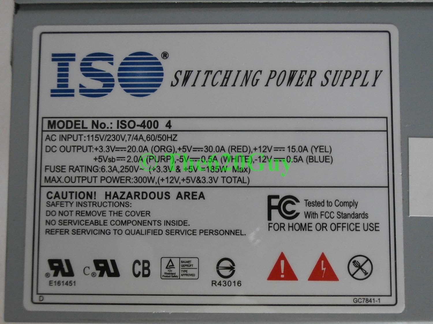

I'm not going to try and imagine what other people are thinking, but without some sort of specific evidence I'm also pretty dismissive of the "R7 240 will cause a BSoD" claim. The power numbers are also wildly high for that card - spec is 30W TDP. And just for grins, it will run Assassin's Creed IV at reasonably low settings: http://www.tomshardware.com/reviews/radeon-r7 … 250,3717-8.html
That review might be where they're getting "120W" from too: http://www.tomshardware.com/reviews/radeon-r7 … 250,3717-9.html
But it's worth noting - that's GLOBAL power draw, not just the GPU.
The chart below shows total system power. But it begins at 57 W, which is the idle system use with its monitor output shut off.
Note that you can't just subtract 57W from the figures, because there's CPU/system load "hiding" in those values as well. But what you can get from that, is that Tom's test system with the R7 240 is drawing a peak of 122W. It's a very efficient little card, and should do just fine. I'm not sure exactly how high of performance you could expect from it in Oblivion, but given that my 6800GT and 7900GS didn't have many problems with that game when it was new, and you probably have a much better CPU than I did circa 2006, I would expect it to be playable. 😀

The 12V rail rating isn't great, but R7 240 is only ~30W, so I don't see why you couldn't get away with it. Any reason you can't upgrade the PSU? I mean, Corsair CX430 (or similar) isn't terribly expensive, and would eliminate a lot of this concern.

600W is way overkill for what you have. Just about any 350-500W PSU with atleast 25A on +12 would be plenty

Make "Sentey"?
Typical efficiency 70%?
20A (240W) on 12volt rail?
240+150+10=400W MAX on all rails together, but still the label says 600W?
1 year warranty?
ATX spec version 2.2 compliant? Come on, for 7 years now we are on ATX 2.3 spec!
This PSU screams "LIE" all onto your face.
Seriously, an ultra cheap Corsair CX430 would have been a much better choice, covered with 3years warranty.
