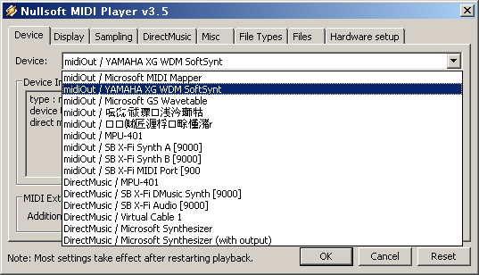

In Winamp there are still two MIDI devices showing up in Chinese however, so this is probably caused by some other font. I think it's displaying them as UTF16 instead of UTF8 or ASCII. It's not much of a problem since I know which is which, but still.. it's not normal. Any ideas on what could cause this?
[edit: attached screenshot]
    15.49 KiB

And those 2 devices look fine outside of Winamp, right? Tried reinstalling them?

Yes, this happens only in Winamp. These devices are MT32emu and the new OPL3 emulator. Wouldn't be surprised if it was just a Winamp bug, one version of Winamp had a bug where all Milkdrop shader scripts were read as UTF16, also resulting in Chinese and other weird characters.
