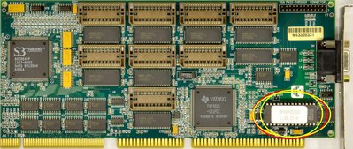

Looking to revive an old VLB graphics card that does not seem to wanna work anymore. I cen't see any visable damage to the card so I'm assuming it's either memory / bios related.
Does anyone have this card that I could maybe get a fresh copy of the Rom Bios, thanks.
To view the card either use link or attachement.
Number #9 GXE64 Pro VLB

Awesome VLB card. I am really jealous. Hopefully it is just the BIOS...
Bios is availible here: http://www.vgamuseum.info/index.php/cards/ite … 54-s3-vision964
This is the link to the bios: http://www.vgamuseum.info/index.php/cards/ite … af9541b8633dd09
Maybe it is from a different brand, but who cares as long as you just wanna check that it is still working.
If it works then you can also make a request there to get the "correct" bios for your card.
I also downloaded generic bios for different cards (S3). And it worked well.

Reply 2 of 10, by Robin4
As i always said, make proper copys of your bios files.. These cards are that old. that eprom loosing there memory, so bios program getting corrupt.. and graphics card will fail..
I really recommend to replace all of these roms on your older devices, sooner or later they all will fail.

Reply 4 of 10, by Robin4
I dont know for sure if a chip would degree after some time.. But the basic thing is indeed to reprogram them.. Also keep a backup rom file in possession if something goes wrong, so you have a fall back..
But i would recommending to replace the eprom it self as well, definitively with it looks worn out or the pins are to much corridated.
At least it would work for about 20+ years again..
Reply 5 of 10, by moturimi1
These UV eraseable EEPROM do not work for me. I tried a lot to delete the ROM content.
But it did not work. Neither with a UV lamp (365 nm exitation) nor with a broad band UV lamp (200-400 nm).
I prefer the Winbond 27C256 and 27C512 EEPROM. Works great!
Reply 6 of 10, by 386_junkie
Thanks for all the contributions so far.
Robin4, this is very good advice... something i've planned to do for a while now (a project in itself) but had not got round to it until recently. I would recommend to anyone the same thing... backup ROM's keeping both a spare soft / hard copy. Motherboards, graphics cards... the lot!
jwt27, I will not use the same ROM... I will probably play it safe and just use a new ROM / flash file. This way if the card boots... it can be used for 20 years+, to reflect and confirm what Robin said.
Moturimi, the kit i'll be using required the ROM to be under the lamp for upto 24 hours. How long do you leave it under for? But yes most of the devices I have that use a ROM works with the 27C256's. If i get some blanks instead of erasing older Bios's (for the meantime) I will be sure to look for and get the Winbond variants.
