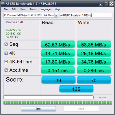

Reply 15 of 36, by TELVM
Snayperskaya wrote:
... If you have a reasonably new main PC (anything Core 2 Quad and up) you'll definetly notice the difference. For older rigs probably not so much since the hardware will be a bottleneck on newer OSes ...
Even a cheap SSD handicapped by PIII era hardware is still orders of magnitude faster @ 4K than any modern HDD.
45.61 KiB
838 views
40.23 KiB
838 views
Not to mention the access times.
Let the air flow!

Reply 17 of 36, by PCBONEZ
TELVM wrote:
Even a cheap SSD handicapped by PIII era hardware is still orders of magnitude faster @ 4K than any modern HDD. […]
Yeah.
Comparing SSDs in RAID-0 to a single SATA drive is fair.
His point about older rigs was that how fast the drive can talk to the controller doesn't make a lick of difference when it has to pass through a conventional PCI bus that maxes out at 133Mb/s.
Even a plain 1.5Gb/s SATA drive will saturate the PCI bus in under 90 ms. After that you are bottle necked at 133Mb/s. Actually less because PCI bandwidth is shared.
Reply 18 of 36, by TELVM
🤣 You got it wrong, that's one single SSD, the Promise raid card is there just for providing a SATA header to plug it into. As you said above, SSDs in RAID-0 make little sense.
Even though the 133 MB/s PCI bus severely handicaps this SATA II SSD, sequential speeds are much better than 440BX native ATA33, and it still destroys any MODERN HDD on 4K speeds and access times.
Let the air flow!
Reply 19 of 36, by PCBONEZ
Though not my favorite anymore, I've been using Promise cards since ATA33 was the fastest PATA available. So, ~18 years.
I still use one in my Windows happy home theater setup but in RAID1. It identifies as Promise 1X2/RAID1 - because it's in RAID 1 mode.
Yours identifies as Promise 1+0 Stripe/RAID0 - because it's in RAID 0 mode.
Promise cards will not go into a RAID mode with only one drive attached. The firmware won't let them.
With one drive it should say "single disk" or "JBOD" or similar.
I will say it again.
Bragging about the speed between the drive and the controller is pointless when the controller has to transfer through a 133MB/s bus on it's other side.
Absolutely NOT "orders of magnitude faster" as you stated on PIII era hardware.
I'm so happy that you are so happy about something that is over with in under 90 milliseconds. After that it's bottle-necked sequential or not..
