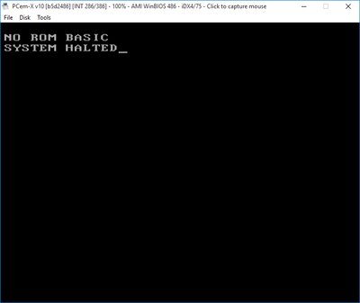

I have treid so many times with that emulator restarted and even created the hard drive from its own function, and stil wont find it, what am i doing wrong here?
Reply 2 of 15, by Nic-93
all i make is a 2 gigabyte drive with 30 megabytes of ram memory availble and amibios 486 DX4 100.
and i would get a no rom basic error to, and the hard drive is not formatted, it is found by the auto detection, even stil it doesnt like to boot up
Reply 6 of 15, by Nic-93
Alright, i had made a hard drive image, and adjusted the virtual machine to find the floppy drives, and i can sort of manage to start up ms dos install but when it restart's to get the formatting ready then it does that no rom basic system halted error again.
Reply 8 of 15, by Nic-93
But i get this error message recently when i treid to start up and do what you said, after i where getting ready to format the drive as you told.

Reply 11 of 15, by alexanrs
You said you could start MS-DOS install at one point. If you can't boot from a floppy then something is set up wrong - I have used PCem and any setup I have seen starts from floppies just fine.
Reply 12 of 15, by alexanrs
Oh, and please do change the boot order (if possible) to have the floppy first. God knows if the utility that created the HDD put some weird MBR code that calls the ROM BASIC on failure.
Oh, and when creating partitions, make sure you flag one as ACTIVE on FDISK, or it won't boot as well.

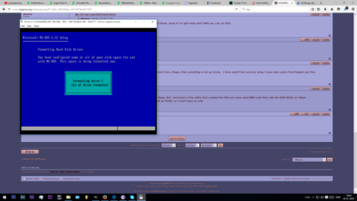

Reply 14 of 15, by Nic-93
You where right, it was doing a weird boot setup, and this picture explains itself
