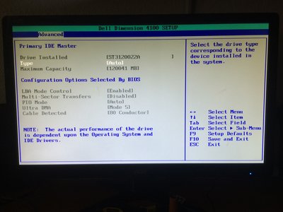

Its set to ultra udma mode 5

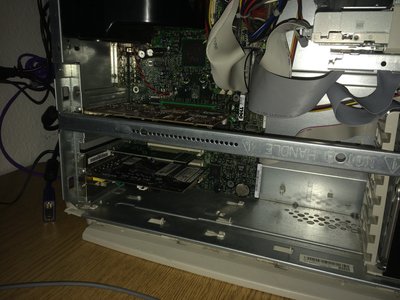

    Inside

Reply 6 of 39, by PhilsComputerLab
Ok.
How long did you wait, when it froze, before you shut it down?
Give it several minutes, it might be looking for a device.
Similar issues happen for me when I don't have a floppy drive connected. At two parts of the installation it will hang for a few minutes.
Also swap out common culprits, like the installation CD, the optical drive (read error), the IDE cable, RAM and HDD.

Reply 8 of 39, by archsan
Why's the HDD on "cable select" and not on "master"?

Reply 10 of 39, by Oldskoolmaniac
Ive taken out all cards at one point, but always do cable select for the hdd on all my towers and master on the first cd driver except for the really old towers they only like master

Reply 11 of 39, by clueless1
Just for fun, switch from CS to Master as a troubleshooting step.
Reply 12 of 39, by Oldskoolmaniac
cable select is automatic on an 80 conductor cable but i will give a shot on the master pin and see where it goes
