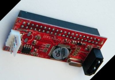

There also exists IDE to SATA adapters, which plug transparently onto the IDE port on the back of the drive, and allow you to run a SATA cable to the motherboard. They require a floppy power connector (besides the connector that's attached to the optical drive). The only caveat I know of with these adapters is that they will always down-rate your drive to UltraDMA 2.
