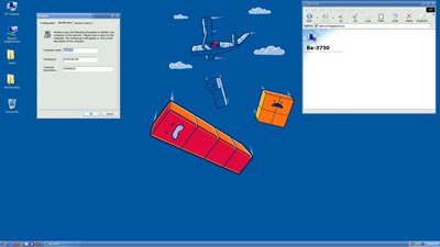

This has been bugging me for years and i cant figure it out windows 98 will not connect to anything on my workgroup, it see's my nas and I can open it, but it doesn't show any files or folders.
My windows 95 machine connects to it after i install ftp/ip client with nothing else added and that's even older so whats with 98?
I was able to get my windows 8.1 machine to connect to the 98 machine tho (not possible in vise versa)

I don't know, but I had a similar issue on my Win 98 rebuild. I can share out a folder on my D: drive on Win 98 and see it from my Windows 10 PC. I can also drop files onto that drive from my Win10 PC since the internet is stable and works lightning fast over there compared to using Firefox 2.0 on Windows 98 with a 10/100 PCI ethernet connection. But I can't do the reverse. I could see the PC, but can't really open anything without locking up Explorer.exe and having to restart it. I'll tinker around with it over time, but it's not high on my to-do list, if you know what I mean. Hell, it was almost an adventure just to get it on the network via TCP/IP after I reinstalled Win98. I had to reread all the stuff I had forgotten over the last 17 years since I first bought that PC.

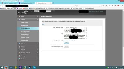

Your NAS should have a smb.conf file, you need to access it via telnet or other means. How this is done on your NAS, I don't know.
Synology also dropped Lanman support a few months ago, I had the same issue.

would these keys have anything to do with it, I know that when windows 98 was release Microsoft had the bright idea to change the certificates and in windows ME i can connect with out problems either.
Heres a screen shot of the certificates on my NAS settings.
