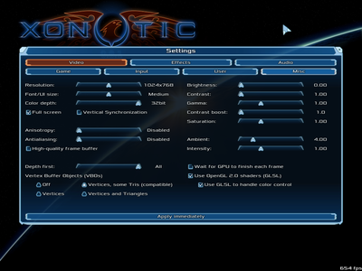

First make sure you set your resolution and color depth to 1024x768 and 32bpp:

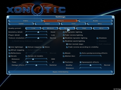

NORMAL: While the Athlon/9800Pro seems to run out of video memory on this test, a P4 2.8/6800GS can run at Normal just fine.

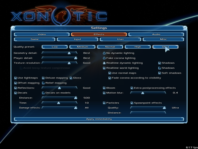

ULTRA: All the game's eye candy is turned on.

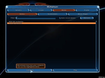

To run the benchmark, go to Multiplayer->Media->Demos and choose the-big-keybench demo, then click the Timedemo button at the bottom. Very important: run this benchmark twice and take the results of the second run. I've found that there's a lot of caching going on on the initial run, so the 2nd run is more representative of real results.

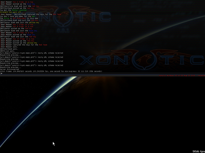

When the benchmark completes (anywhere from <20 seconds to over 5 minutes, depending on the speed of the run), hit the tilde key (~) to bring down the console. The results will be listed there:
613.57 KiB
16271 views
There are 10510 frames in the demo. Take the seconds to complete (rounded to two decimals), along with the one-second fps min/avg/max results and enter them into the database. The FPS column will auto-populate from the time value you put in. There are separate tabs for LOW, NORMAL, and ULTRA, as well as a free-for-all tab that you can add other configurations on. Feel free to submit results for all three detail presets. People can then download the spreadsheet and sort however they wish.

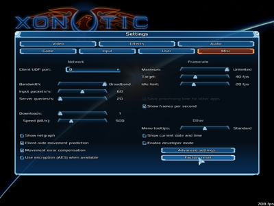

If you've already go Xonotic on your system and have changed the settings, you can reset all defaults here:
