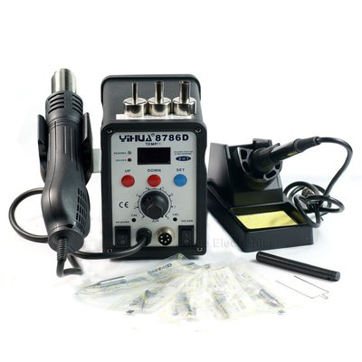

Reply 7 of 11, by MCGA
OK, that makes sense. I noticed people using the hot air for newer projects and it really did seem to make it much easier with the really tiny stuff. I would like a vacuum pump, but the price is more than I want to invest. I was going to use a solder wick, which I've seen peeps like that 8-Bit guy use.
I'm going to start with a cheaper one with the blower, so I can tinker with this stuff to get used to it. And if I find myself going full out on soldering, then I'm going to buy a Hakko next. I found a cheaper Hakko model, but when I add in the holder and cleaner, it's a better deal to just pay a bit more for the FX model.
I have a another question showing how little I know about this stuff. What's with the various names? I see the same model number on lots of different brands. So with 8786D, I see a few variations on Amazon. And I noticed the 936,937, etc.
Reply 8 of 11, by gdjacobs
Chinese clone manufacturers have been making those for years (with varying quality). They're generally better than a non temperature controlled station, but not as good as the real thing.
The T12/T15 clones have the advantage of being compatible with genuine Hakko tips. I have one that I actually like better than my FX-888D.
