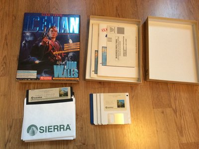

Iam installing a lot of my BIG BOX games on a dos machine, and i have ran in to trouble with many of the games has corrupt files or just one file..

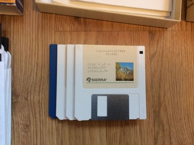

This game i came all the way to floppy 4, the last one.. I cant read any of the 2 files resource.000 and resource.004, both from floppy 4 of 4.
Pleas if someone had those file for me to replace!

Reply 3 of 21, by keropi
damn, checked my disks I have the 1.023 version... maybe an EU/US thing?
my copy was bought in Greece back then
Reply 7 of 21, by keropi
So what's the deal with 1.033 ? Fixed bugs?
Can't the damaged files be retrieved from the other floppy format since the game came with both 3.5" and 5.25" media?
Reply 8 of 21, by root42
Yes, 1.033 fixed some bugs related to the score I think.

Reply 10 of 21, by collector
The resource files were split into smaller sizes for the 5.25 diskettes and spanned across more diskettes. This required a different map file as well.

I dont know how to get a md5sums from that file as iam not able to read it.
But my file size should be:
resource.000 26 989kb
resource.004 670 883kb
