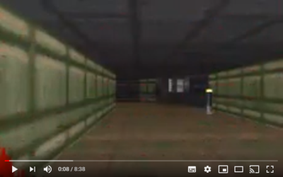

    • Technical reasons. Have you ever heard about pixel-perfect scaling? Do I need to use some patch or something? No reason to do so. Simply record thing as is (640x400 and 320x200, 24-bit RGB in my case) and let do the media player rescaling. With nearest-neighbor interpolation. --scale=oversample parameter for mpv. Combined with -fixed-vo to get perfect (and fast!) result even on full-screen. I've tried Youtube. Almost hour of chewing and processing and with this result:
      176.36 KiB
      470 views
      98.65 KiB
      470 views
      On given bitrate I'm able to get 4× better result with 5-10 minute x264 encoding on my laptop. Now I know exactly what „Youtube quality“ means. I can set bitrate, choose codec, strength of deblocking filter, encoding preset, container format, everything. What can I choose on Youtube?:

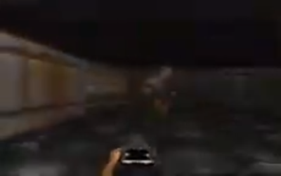

You know what is sick? That it actually works! Look.
file.php?mode=view&id=79585%5D
For some odd reason video is reprocessed into 360p/YUV420 but it is with YouTube controll and link for original which can be embedded as HTML5 video. As long as it is YUV420/YUV444p because HTML5 video doesn't support RGB mode.
