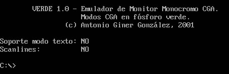

Reply 6 of 8, by Mephisto
The verde prog works within dosbox really well, when i change the machine settings to hercules - then i can start it and have full greeen screen output. But i cannot change the settings to grey palette - even if the mode seems to be changed to Monochrome-mode, as u can see in the pic.
Does it MEAN that the Monochrome mode is Activated ??? Cause i cannot read Spanish 😒
I keep searching; maybe i will find such a Emulator in the "endless universe of the internet". Once i find it i will post some an answer in the forum (in case other ones are such crazy people like me 😁 )

Reply 7 of 8, by eL_PuSHeR
VERDE is Spanish for "green" and that's exactly what verde does. It emulates CGA monochrome but using shades of green ONLY.
PS - I will translate docs into English if I feel brave enough. 😁
Here's an exerpt from docs.
VERDE is a program that tries to emulate visual appearance of old green phosporous displays under VGA ones. Something that may sound stupid at first sight, has its own foundation. In fact, newer display hardware, with its high definition, are a very bad support for the primitive CGA card graphic modes. These modes, emulated nowadays by VGA cards, appear to be totally different from the thought we had those of us who played on a real CGA monitor. Due to this reason, somes games that appeared great in the 80's (keeping in mind CGA's big limitations), appear now somewhat disvirtued. Some of us have experienced that dissapointing feeling after downloading with great hope some classic PC game and finding out that it appears to be something totally different as we recalled it (without counting speed factor).
