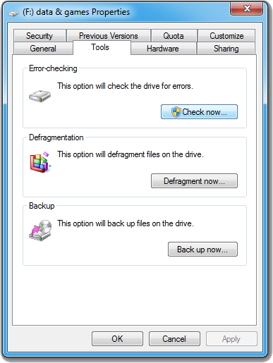

It's called "scan for bad sectors", then repair. It's part of Windows' error checking utility under the Tools tab,. which appears after you right-click on a particular hard drive on Windows Explorer. It doesn't exactly write the data anew over the old data, but move data from bad sector to a new , good sector, to prevent data loss.
