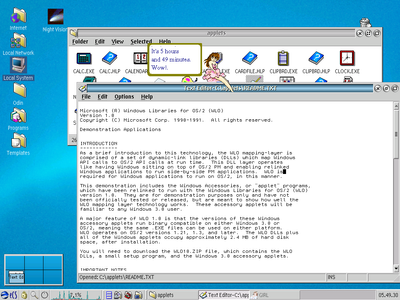

    146.26 KiB
    3578 views
    Read me!

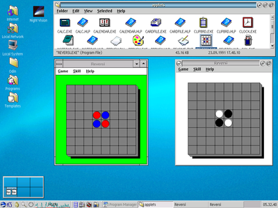

    181.35 KiB
    3578 views
    Now together!

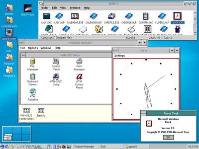

    137.26 KiB
    3578 views
    Windows 3.0 Clock on WIN-OS/2

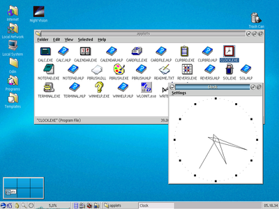

    212.74 KiB
    3578 views
    Windows 3.0 Clock on OS/2

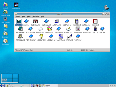

    239 KiB
    3578 views
    The "applets"

The sample applets I ran on my eCS installation before, ran as reported in the linked Wiki.
Win-OS/2 (run.. in Program Manager) ran them natively, the DOS prompt got the error message and a "please wait".
Apparently, the application tried to boot itself by running WIN command (old Win16 applications had that bad habid).
The OS/2 prompt, ran them natively, just like the GUI.
