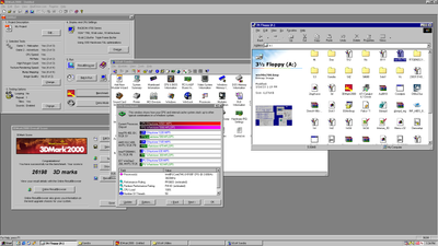

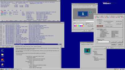

Windows 98 installation process usually ends into a "Windows protection error"/ "VCACHE error" on the latest Intel generations. There are a couple of videos on YouTube with failed installations on 9th gen platform. (using real hardware)

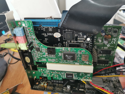

It took me like a working day (5PM to 1AM) to make it happen... but now I have a stable Windows 98 running on real hardware on a Intel Gen 9 CPU, with video (PCI-E ATI X700) and sound Aureal AU8810 (via a PCI-E to PCI adapter). Too bad I ran out of PCI-E slots, because I have a PCI-E to USB card compatible with Win 9X.
**The BIOS for this motheboard (PRIME H310M-E) has a nice option to report USB storage as FDD or HDD.

I think my "special" approach was to use a Windows 98 compatible disk controller. This is how I managed to pass the "Windows protection error" message which was causing a dead end.

Wow, that's very cool to see. Is there any issues with performance or is it as good as one would hope it would be?
Yes, Windows 98 SE runs stable. First I tried a GeForce 7600GT which is not officially supported and even if the drivers installed, the whole system wasn't stable. It was able to run the first benchmark from 3DMark 2K but not the second one. Most games didn't start. Then I installed an officially supported ATI X700 card and with those drivers everything that is game related works fine. Overall the system is stable, no random crashes.
