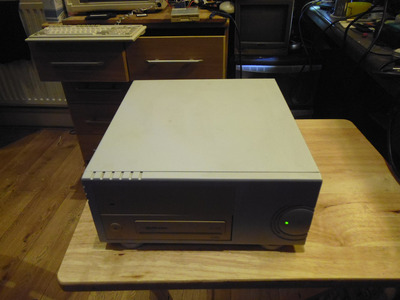

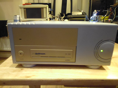

Today I aquired yet another Tape drive unit..
OnStream ?
SCSI interface of course..
The actual tape drive was immediately identified by my early veritas software..and could well be functional.

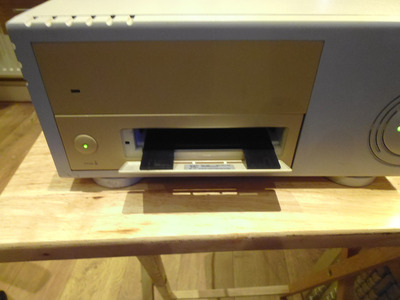

This unit is a little different to my usual encounters..mostly DDS 2/3/4 etc in that I have no idea what tape meddium it uses ?
It may even be that it needs a caddy of some sort ?
It is a dual drive unit in that it also houses a scsi hard drive...which in this case is 50 pin 2gb
Connections at the rear are centronics and provision is made for daisy chain or termination.
I am familiar with many scsi tape drives ...but not this one...so any help would be appreciated.
on the front drop down flap of the tape drive it does indicate that it will handle 30gb media...but what type of media ?
the slot is too big for DDS data tapes.
Strangly the 50 pin 2gb scsi hard drive had been formatted in NTFS...which I have never seen before...
Nothing on it though...no hidden stash of bitcoin.
A very pretty beige box imo...but then I am biased.

Did you google it before posting this?
It doesn't seem to be so unknown and it kinda looks as if the tape cartridges are still available on amazon, though cannot be shipped to my location.
Onstream 30GB ADR
OnStream 30GB Data Cartridge Tape Drive

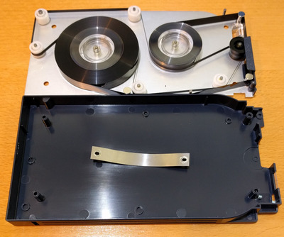

Weird - never seen one of those before. Seems to share some design similarities with QIC so presumably shares its flaws too - tension band in direct contact with the oxide layer of the tape that will eventually perish and either glue itself to the tape or fall to bits and lose its ability to advance the tape. Maybe the drive even has the rubber wheel that eventually turns to goo!

Found a picture of the inside of an ADR tape cartridge:
256.33 KiB
416 views
stolen from twitter
Looks like my guess was right - physically it's an incompatible/proprietary variation of the extended mini QIC/Travan cartridge. Will probably turn out to be about as unreliable too as the cartridges and drives age.
