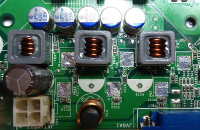

I was going to solder some new MOSFETs on this motherboard but I forgot the position of these.
Indeed I took pictures before, but it was a lot of time ago and I can't find them now.
The required area is the power MOSFETs where are 3 big electrolytic caps.
I need to read the names, one is P75N02LDG, the other P0903BDG. Which goes where? Before I kill components I thought to ask first, the area is small and soldering is a pain.
https://pdf1.alldatasheet.com/datasheet-pdf/v … /P75N02LDG.html
https://pdf1.alldatasheet.com/datasheet-pdf/v … C/P0903BDG.html
Edit: I thought that maybe it's easier to ask which of these 2 Mosfets is high and low.
Thanks in advance for any help.

Does anyone know which is High side and Low side?
Maybe it's easier to find this than a picture.
I looked all over for my pics but no luck so far...
My guess is higher amps P75 (75A) and then P09 (56A).
Edit: I added a pic of the area. Socket is at the top (not visible).
Yes, caps have been removed.

Reply 2 of 17, by Roman555
Nexxen wrote on 2023-08-31, 23:49:
Hello!!
Maybe a schematic diagram will help:
Biostar IG31C-M7S
Look up reference designators, compare circuitry and components
P.S. Yes, P0903BDG and P75N02LDG , TO252 package
    Biostar_IG31C-M7S_VRM.pdf
    93.13 KiB
    51 downloads
    Schematics of VRM

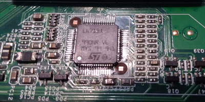

As I was powering up the board to test the other replaced components I stumbled upon a SCD-12 @ 70-73°C.
https://pdf1.alldatasheet.com/datasheet-pdf/v … OWIE/SCD12.html
The IC that regulates power (L6703 by ST) goes to 50+°C.
I'm starting to think that the VRM IC is either busted or not working properly.
I'll solder a single P0903 and see if it blows. If it does, I'll spare the others a order either a new L6703 or just buy a new G31.

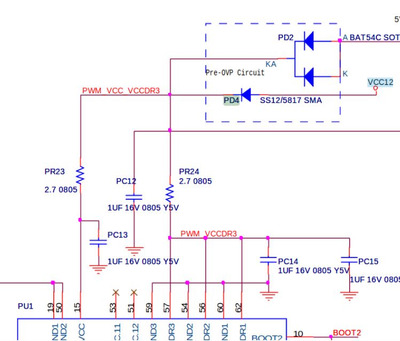

Edit: on the schematics it appears as SS12 on that position, and to me it makes sense as the datasheet looks similar (I'm no tech so it may be my wrong assumption)
I could try to solder a SS12 instead and see what happens, if it goes up to 70°C.
https://pdf1.alldatasheet.com/datasheet-pdf/v … GHENG/SS12.html
Always more than you ask for....... 😀
EDit: 12Vcc to PD4 (highlighted)
Schottky diode; from 12.2V to 11.87V it ramps up to 70°C ----> is this normal? either failing or something else might be siphoning V somehow?
    50.84 KiB
    1142 views

IMO, it isn't normal. What is resistance of load of PD4 (between VCC and GND pins of the chip and between the cathode and GND rail ) ? Maybe the chip or capacitors have too low resistance so current is too high for PD4
P.S. It's interesting why the mosfets were de-soldered...
anode---[SCD12]-|> --- cathode
a)
black probe on gnd and red probe on (1. anode) then (2. cathode)
(gnd-anode) 4.5K
(cathode-gnd) 35.4K
b)
anode to cathode measurements: reversing the probes so that the 30mV are in the anode and then the cathode
black com - red V =39.3K
V - com =5.7K
Desoldered SCD12 measurements:
probign one way than the other
com - V 230K
V - com 5.7K
Motherboard pads:
gnd-anode 12.3K and 50K (cathode-gnd)
anode-cathode
com-v 50K
v-com 32K
Edit: I have no SS12, SS14 could do?
Edit2: I measured a SS14 and it's 30K and 550K (one way and the other). Unless the values are so different it looks like the schottky on SCD12 is close to failing.

It was a cheap budget mainboard with weak 3-phases VRM. So it's better to use only Core CPU (not Netburst) with it.
For testing purposes I would use cheap Celeron-L or Pentium E.
I don't see any short circuits or low resistance in your measurement.
I've seen in Internet L6703 wasn't reliable. L6713 may be compatible here as someone swapped it on other mainboard models.
I don't understand resistance of the schottky. Try to set multimeter into Diode-mode.
Nexxen wrote on 2023-09-02, 15:44:
Then 12.2-11.87=0.33V is lesser than VF=0.55V from the datasheet. It's OK

Btw, I was going through some dead bards and found a L6713. I'll replace the old 6703.
PC#1 Pentium 233 MMX - 98SE
PC#2 PIII-1Ghz - 98SE/W2K
Reply 14 of 17, by Nexxen
I replaced the L6703 replaced with a L6713.
From 70°C to 32°C. Probably it was dead and killing all the power mosfets...
I'll solder stuff tonight and report.
Btw, yoy were right, some p09 and p75 were only hot and with residual charge.
I measured and no shorts...
