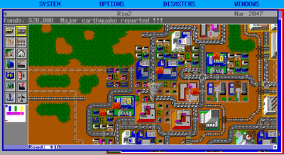

There was plenty of multiplatform games in the 80s, but nobody was expecting miracles - it was obvious that ZX Spectrum version can't be indentical to the IBM PC version of the same game, see eg. Sim City:
5.06 KiB
822 views
20.17 KiB
822 views

Reply 11 of 12, by Jo22
^The 68k version of Sim City was even better than the PC version, maybe.
    91.96 KiB
    804 views
    Sim City for Sharp X68000
