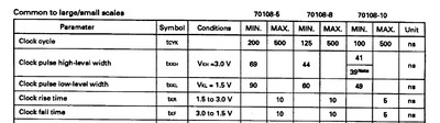

Reply 29 of 37, by Grzyb
Jo22 wrote on 2023-11-24, 05:21:
Nothing about V20/V30 requirements there...
But - https://www.alldatasheet.com/datasheet-pdf/pd … C/UPD70108.html
The attachment v20clk.jpg is no longer available
Duty cycle would be tKKH/tCYK, right?
So, the minimum duty cycles - at the nominal CLK frequency - are:
- for the -5: 69/200 = 34.5%
- for the -8: 44/125 = 35.2%
- for the -10: 39/100 = 39%
Really?
V20 isn't a drop-in replacement for 8088, after all???
Kiełbasa smakuje najlepiej, gdy przysmażysz ją laserem!
Reply 30 of 37, by Jo22
Edit:
Grzyb wrote on 2023-11-24, 05:59:
Right. It's merely NEC's official V20/30 clock generator that features an 50% duty cycle.
Really?
I've never questioned that.
I merely said it's running a bit out of specification here (most things have quite some tolerances). 🤷‍♂️
Wikipedia mentions that 50% duty cycle, too.
