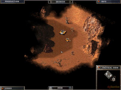

Anyway, three more games I tested, first Black Moon Chronicles doesn't work. It's a simple 2D game and behaves similar to Wetrix, so I'm guessing same cause here.
Mayday: Conflict Earth seems to work just fine. 2D game, but can benefit nicely from integer scaling if you like that for games like this. Though I wouldn't recommend playing this game at all.

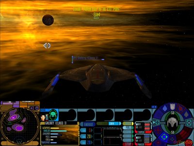

Star Trek: Deep Space Nine: Dominion Wars just crashes at launch. The reason might be somewhere on this page: http://jiridvorak.webpark.cz/dw/index.html (yes, same guy that made the fix for Dangerous Waters)
If you use both that ddraw patch and dgVoodoo2 however it works, performance was really bad on the PC I tested it on (said computer has weird performance problems of its own so I have to test it on another computer later), the game is usually locked at 800x600 so resolution forcing can be very beneficial (can't force texture filtering though). The installer for this game doesn't seem to work properly on newer OS so I had to use Universal Extractor to unpack the game's files.

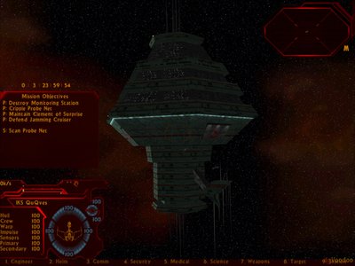

Edit: while I'm at it, let's check if Klingon Academy works, another game fixed by the same guy, this one with a more extensive wrapper that makes the game D3D9. So whether that wrapper or dgVoodoo2 is best for this game is up to the fans (and obviously if they have a D3D11 capable GPU). It seems to work though, higher internal resolutions are very rough on performance. Forced resolutions are fine though. This game has bad UI scaling and dgVoodoo2 can be helpful with this.

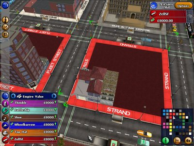

Reply 3684 of 3949, by ZellSF
Monopoly Tycoon works great, no specific advantages to running it in dgVoodoo2 though and you'll need WinXP if you want working music.

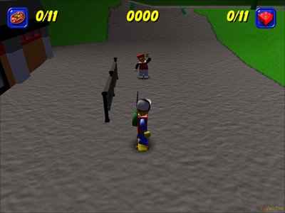

Lego Soccer Mania has severe rendering glitches in menus and some in gameplay. It works fine natively. Here's a video showing you what I mean:
https://www.youtube.com/watch?v=xoq8VqQoqYI
Sorry about the frame skipping, all I had to capture with was Fraps and it hated this game, plus the game randomly crashes when scanning for profiles. There's a demo here:

I tried Star Trek: Deep Space Nine: Dominion Wars on my GTX 1070/i7 4790k setup I get constant 60 FPS. On my GTX 680/i7 860 I got drop downs to 10 FPS. While there is a huge performance disparity between those computers it shouldn't be a 600% disparity. Not related to dgVoodoo2 though, there's just something weird with that computer.
Edit: Also tried Lego Island 2, an earlier game by the developer of Lego Soccer Mania, to see if it had the same issue. I already know their later games (Drome Racers) work perfectly. I didn't test their UEFA soccer games though which I suspect might use the same engine as Lego Soccer Mania. Mainly because I don't want anything with UEFA in its name anywhere near my computer. At any rate, Lego Island 2 works fine. Usually limited to 1280x1024, but there's a resolution hack available for it.
