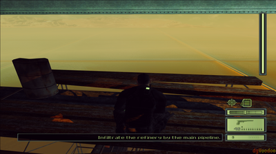

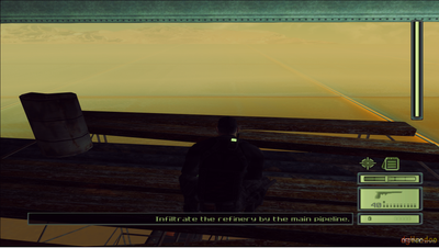

In SC1 if you set the game exe to 640x480 and in DgVooDoo you force the resolution (not to high) the coronas around lights will not flicker anymore.(2.54 till 2.6 something version of DgVooDoo comes in handy here-> doesnt shift the effects ).
Beware some levels will not look right. Oil Ref level, water will be broken. You can play this level with force res off and set the res in the game or 13ag widescreen.

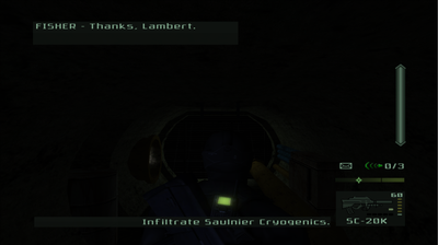

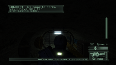

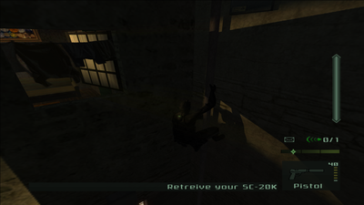

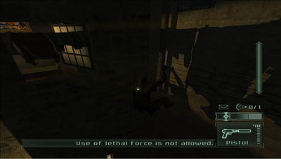

Reply 164 of 234, by hishamerrish
Splinter cell 2 HD texture has some bugs too 🙁
shadows not render correctly and some places the shadow and the light are a little weak
the light not rendering at the start of the Paris mission
the bloom has been lowered you can see that from the light on the Sam back ....
