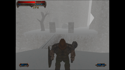

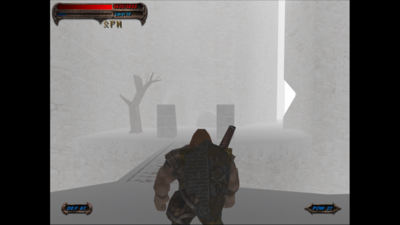

Reply 1054 of 1111, by KainXVIII
Fog does not look right in D3D mode? Or is it just me, maybe gamma is too bright (ingame its much brighter than on screenshot, but same in glide mode)
WiP61
The attachment Снимок экрана (16).png is no longer available
Nglide
The attachment Снимок экрана (20).png is no longer available

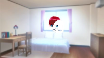

Reply 1055 of 1111, by Arkblade
Artificial Academy 2 are completely broken rendered.
The attachment 20190612212515_1.jpg is no longer available
version: WIP61
in newer win10, at the moment there is no way to run this game on hardware render ......
It can not do normal rendering(not using dgVoodoo2), and causes intense lag. due to window's DX changes on win10.
