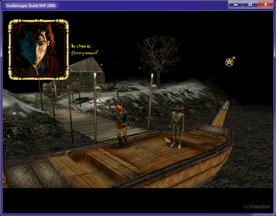

Right now, I'm fiddling with Soulbringer (GOG version) and having little trouble, I set the breakpoint on DLL entry point and it isn't hit, I set it on DDraw.dll exports any they aren't hit...it does throw out a message box complaining that it can't enumerate display devices and pauses there. I also see a bunch of these scrolling through the stack, so hopefully it gets me somewhere:
DXGI ERROR: CreateDXGIFactory cannot be called from DllMain. [ MISCELLANEOUS ERROR #76: ]

Reply 3 of 38, by UCyborg
GOG version patches, which take care of aspect ratio and cinematic issues, don't work when we put dgVoodoo in game folder, but dgVoodoo can take care of aspect ratio (select 4:3 resolution in game, set Scaling mode in dgVoodoo to Stretched, keep Aspect Ratio). They also don't work with DX7 modes (stretched image). EAX enabled executable also doesn't work, just crashes, seems like they haven't patched it like the non-EAX one. I do have working Creative ALchemy installation, including EAX Unified, which other games are able to use just fine for querying EAX capabilities. Parts of the game also stutter a little.
So I went on and patched the retail version files, put dgVoodoo in the folder and things look mostly fine at first glance. 256-color software mode works as well as DX6, which allows 32-bit color mode (though game textures are only 16-bit I think). DX7 modes result in black screen, music plays, the game runs, just nothing is shown. Seems to run smoothly. EAX .exe works as good as the other one.
The game really doesn't like AMD cards out-of-the-box, there is another issue in addition to DllMain. Impossible to even reach main menu as long as it's running via native Direct3D, no matter what. Get dgVoodoo in its place and it works!
One oddity that remains when ran through dgVoodoo is the intro cinematic, it runs in a small borderless window on the top-left and the taskbar flickers like crazy when said window appears when scaling mode is set to Unspecified. If dgVoodoo is allowed to control fullscreen/windowed state, borders appears around it and there is no taskbar flickering. If I set Stretched, keep Aspect ratio, it appears fullscreen, but there is just blackness (just like with native DirectX). GOG version has a patch for that that only works with native DirectX. Similar problem exists with a brief screen with game logo that displays after the intro cinematic, it appears in a small borderless window in the top-left corner.
Launcher can be buggy, probably the best to use it to set resolution then launch the game via one of the other executables. Can run via native DirectX 6 or 7 with some fiddling on NVIDIA graphics card, best not to try though.
TL;DR This was all over the place. It's a buggy game out-of-the box, less buggy when you get it running via dgVoodoo. You can download patched binaries and try it out with dgVoodoo if you'd like.

I've just tried it and indeed, cinematics doesn't work in fullscreen (probably Intel Indeo which is not supported through dgVoodoo, can only be displayed in windowed mode, old issue) and DX7 gives black screen (that one should be fixed).
Reply 8 of 38, by Dege
Dege wrote:
Thanks! Cool!! 😎
Didn't have much time so far but:
- I was wrong, cinematics are not Intel Indeo. This game gets switched back to windowed mode at movie presentations (must do sg similar like SC1) and the wrapper couldn't handle that unexpected situation, movies fixed
- Rendering through DX7 is also fixed, the game performs its texture uploadig in a valid, but for dgVoodoo an unexpected way, fixed (at least it got revealed)

Updated all patches to handle the case when DllMain returns FALSE when called with DLL_PROCESS_ATTACH, in which scenario the library must be unloaded. For correctness sake.
I've also upgraded the Soulbringer patch to get it working a little better under native DirectX. DX7 renderer doesn't enable VSYNC on its own so it runs too fast which makes the game glitchy. BTW, I noticed that whatever guys at GOG did with their version, their tweaks also influence the game flow itself in subtle ways and introduce stutter. Like in the first cutscene, the ferryman goes around the house to reach the door like he's drunk, then noclips through it, funny. Original version doesn't have that issue.
I'm glad you found the problem with DX7. I wonder though, does Soulbringer's DX7 mode have VSYNC under dgVoodoo without forcing it? Because it seem to get activated only with DX6. It must run at 60 FPS, otherwise it gets glitchy. Interestingly, it runs at correct speed on its own under native DX7 if you leave maximized windowed mode enabled. But contrary to what the ReadMe says, at least under native DX7, it runs slower than DX6.
About Indeo Video, it works with Mafia just fine, though I remember you said one time things don't work when DirectShow is involved. It just takes running regsvr32 ir50_32.dll from SysWOW64/System32 directory. Windows XP compatibility mode might work too. No issues with dgVoodoo in that regard, though parts of the game are still flickery, at least with Water Shader Mod installed, which is actually D3D8 proxy which injects shaders to make water have reflections. The proxy is named d3df.dll so therefore it modifies import table in a game engine binary to point to that. I haven't tried without it yet.

One more thing regarding Soulbringer, in software mode, it crashes or hangs in one of graphics driver DLLs when you use quit menu option to close it.

Reply 11 of 38, by Dege
No, it runs at ~1200 FPS through DX7, so there is no vsync.
Well, the problem is not with the codec used for movies but the fact that the movie player renders the movie through DDraw/DX8 or legacy GDI.
GDI is not compatible with DXGI in fullscreen that's why no movies in those cases. Intel Indeo always comes paired with a videoplayer that renders through GDI (ok, maybe I'm wrong, I didn't checked the cases when there were no problems with the playback 😀 ).
On the other hand, DirectShow should be OK because that renders through DirectDraw. The latest WIP contains a fix for Win10 though, DDraw+DX8 scenario didn't always work (some mysterious dll path-thing when DShow loads DDraw).

Reply 12 of 38, by Dege
It does for me too, with my nVidia. It gets stuck gratuitously in a swapchain call (WaitForSingleObject in the deepness of the driver). 😕
Works OK with Intel HD.

Reply 14 of 38, by UCyborg
One more thing when you have the time, can you try Soulbringer with forcing VSYNC off through drivers and check whether it runs slower or faster in DX6 mode on your end?
